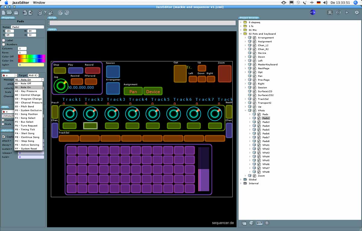

lemur from jazzmutant
this one is a 800x600 Screen you can touch with all your fingers (and more) and control many more than just one parameter with 2 fingers (knobs): there are rubberbands, balls with fricton and refelction at the wall (real physical bounce) and they can have a "lifetime". there are of course sliders and buttons like on enterprise NCC-1701D and E =/\=.
it communicates via ethernet / IP and uses the OSC "standard" (well ,that can be read by reaktor, Max/msp, PD etc, but it can not send controllers but via a very simple helper in reaktor, max etc.. it can change it all to midi or even higher resolution)
it is in fact a tft with a computer and net connection aboard. 2k€ is not cheap but it is really a cool control toy..
all controll "fields" can be set up by yourself (of course..)
video - play with vlc..
Lemur tft touchscreeen movie:
->>with sound lemur_soundAVI.MP4
lemur_baelle.MP4
lemur_fader.MP4

The Jazz Editor
