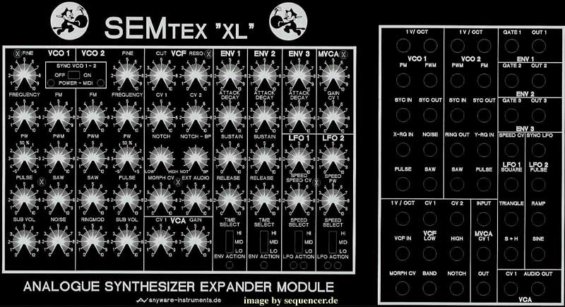

Brief overview: the SEMTEX XL features
* 2 VCOs + 2 SubOscillators
* Multimode-Filter with Filter Morph (by CV) LPF to HPF
* Ringmodulation, Noise
* FM, Sync, 2 VCAs
* 3 Envelopes with Lo,Mid,Fast-Switch,
* 2 LFOs with Lo,Mid,Hi-Switch
* Midi incl. lots of Features
* (4 CVs, Controllers, 6 Gates)

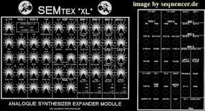

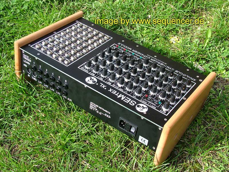

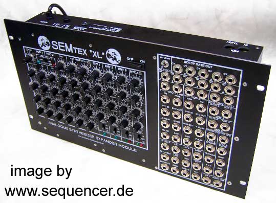

The SEMTEX XL, is made of very robust metal with massive wooden side bars (they're really beautiful!). Because Anyware-Instruments didn't want to make do with scatchy knobs, they took the best option they could find - high quality knobs with very fine tuning qualities, the most expensive choice. They have a smooth feel to them, and all share the same turning resistance. Further, they used Switchcraft jacks for the patchfield, because SEMTEX is fully MODULAR!!!

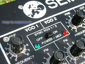

The SEMTEX has borrowed a lot from the Oberheim SEM, but it's not a clone. It offers two VCOs with their own SubOscillators, hard sync is available. Frequency range is infinitely adjustable, there's also a fine tuning button for percision work.
The VCOs feature saw and pulse with variable pulse width. SEMTEX is prepatched, LFO1 is used for PWM. Of course you can ignore all of this, if you wanna do the work yourself by patching yourself. White noise and a ring modulator are available as well. SEM users probably won't remember this, because the original module had neither SubOsc, nore FM, nore ringmodulation.
The VCO sound is expansive and extremely beautiful. If someone is looking for a competetor to compare with the real thing, this is it.
Main attraction is the filter section, not the VCO part. Here is something, you rarely or never find in other synthesizers. Morphing from LowPass to HighPass via Notch Filter. To top it all off, morphing can also be done through voltage control!
This filter is the Oberheim 12 dB/Oct-filter, which is available in the SEM with the addition that beside voltage controlled morphing, the endresult can be adapted to the BandPass function.
BandPass is not voltage controlled, but the filter still sounds warm and full, even with high resonance settings. Self oscillation is no problem, either. Those who prefer filter-FM should try the SEMTEX here, it sounds extremely warm and congenial. Even vocal sounds can be imitated.
In addition, all filter types are within reach on the patchfield for simultaneous use.

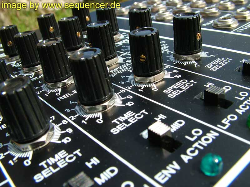

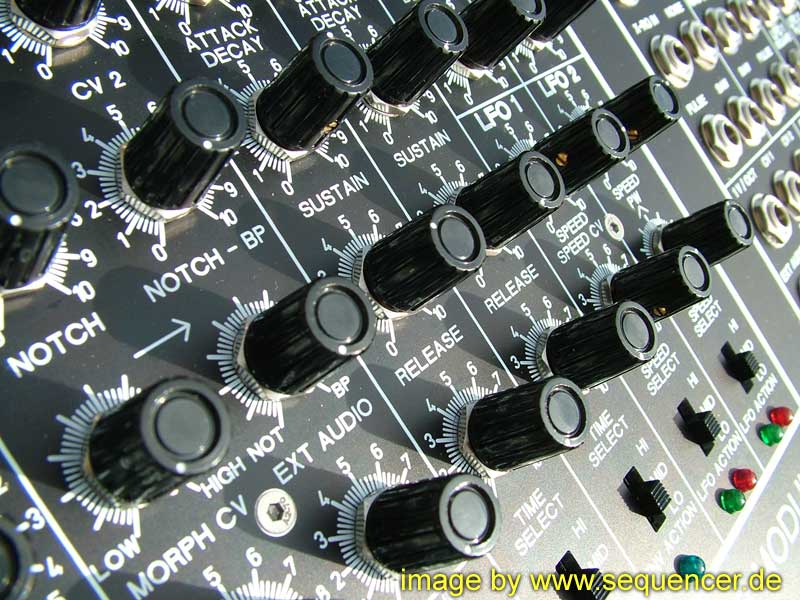

As we said way back there at the beginning, the SEMTEX comes with 2 LFOs und 3 envelopes. The envelopes are set up in the usualy ADSR structure, with one exception that offers a simpler AD form. In addition, the two complex envelopes feature a sort of "gear shifting": Low, Medium, High! Have you got it? Right: fast as a flash or slow as a summer day. These envelopes are very snappy - even faster than those of the great Roland Jupiter-4!
What about the LFOs? Taken from the above mentioned HölLFO, they feature the same "gear shifting" function. That means, the LFO goes up to the KiloHertz area (> 1000 Hz)! I personally enjoy the dual-coloured LEDs a lot - each sharing half of a wave cycle with the other. That makes visualizing the LFO up to very high speed possible.
Various kinds of pulse and saw are available on the LFO. You can use all of them simultaneously - just like on the Yamaha CS-40M - although, of course, they have the same speed.
An additional feature of LFO1 is a ready-for-use Sample & Hold - "Random Velocity" - whereas LFO2 comes with Sine. The LFOs can be synchronized. For those who are still not satisfied, there is a CV-input for tempo of LFO1.

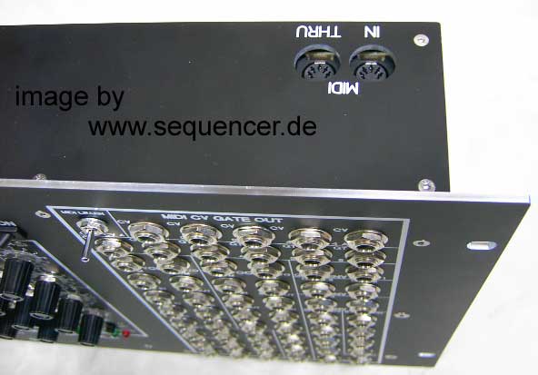

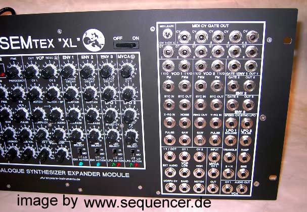

How do I keep all of these dynamics under control? The complete analog SEMTEX not only includes a complete patch field plus CV/Gate outputs (backwards), but also a built-in MIDI interface. Connoisseurs of the DIY-scene maybe know Marc Barreille's Papareil-Site. He?s the father of this Midi-Interfaces.
Along with the Midi-In port the SEMTEX offers a serie of analog trigger inputs and a further six pack for voltages. The keyboard voltage (CV) and the velocity are there in the first place for the two cv-outs. The remaining four CVs and six gates can be freely routed with the use of the PC software.
Midi Clock and pitchbend data are offered as well. Considering ist origins (one-man company, DIY, etc) the MIDI functions are generally very satisfying and may even be used to control other modular systems. The big guys can't offer more! The only little disappointment is the fact, that you need a PC or at least an emulator for controller adjustment. On the other hand you can also feed the system the necessary information with the help of sys-ex data. It's only a matter of time, until the necessary tool (maybe a sound diver adaption) will be available.

new: the 19" Semtex XL
it has it's power switch on the front panel and the top 2 rows are the midi CV + gate outs, that can acced from the front, the midi jacks are on the back side.. there will be a sequencer around summer 2006..

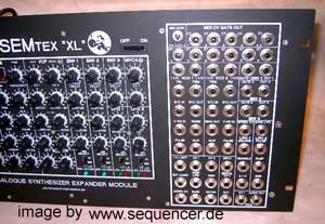

die 19" Rackversion gibt es bereits und sieht so aus:
anyware semtex rack synthesizer
