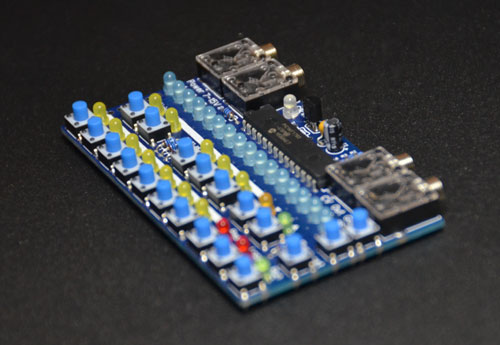

niedlich: division 6 business card sequencer

minimalistischer 16-step cv/gate-sequencer von division 6 als bausatz:

jetzt auch als aufgepimptes doppelpack im eurorack-fromat zu haben:
This kit gives you two handy little sequencers behind one Eurorack panel. Why would you need more than one sequencer? Why would you need mini sequencers?
More sequencers = more steps
Use one for playing notes and the other for transposing those notes
Can be used as a clock divider
Run in parallel for multiple CVs / triggers
Each one gives you the standard CV and gate out, plus an ACC out (Accent? Accessory?) Use it to open up a filter, enable a glide, trigger a drum, or whatever you can think of.
The two sequencers will run completely independently, or you can daisy-chain them using the XP IN/OUT jacks to create sequences of any length.
Each sequencer has its own internal clock to get you up and running in a hurry, but you can connect an external clock if you need greater control of tempo or want to sync with other devices.
The module stores your latest sequence even when the power has been removed.
While this kit is designed to give you a Eurorack module, the PCB patterns for the jacks also have holes that will accept Johnson/Cinch-style banana jacks. There are also standoff holes on the main PCB, so you can mount them behind your own custom panel.
This module has lots of LEDs and is very shiny, but only two of them are ever on at a time which keeps it from loading down your power supply.
Inputs
CLK IN (External clock input)
XP IN (Expansion input; Starts sequencer back at step 1. Use for daisy-chaining multiple units)
Outputs
XP OUT (Sends pulse when sequencer goes past last step. Use for daisy-chaining multiple units)
CV OUT
GATE OUT
ACC OUT (Can be programmed on or off in each sequence step)
Features
CV OUT covers 5 octaves, and can be tuned using front-accessible trim pot
Sequences can be set to any length up to 16 steps by using LOOP feature
Setting a step to REST holds previous pitch and doesn't fire GATE
In Standby mode, sequencer can be used as a tiny keyboard without altering programmed sequences
Specifications
Power supply: +/-12VDC (reverse-polarity protected!).
Power supply (Optional): +/-15VDC
Current draw: 30ma(+12V) / 0ma(-12V) / 0ma (+5)
Width: 18HP
Depth: 0.83in / 21mm
(ich hatte mir ja die urspruengliche version gebaut: hat bestens funktioniert, aber jetzt finde ich ihn nicht mehr, weil er so winzig ist. :sad: hab darum jetzt auch noch das euro-kit bestellt - das wird dann im rack festgeschraubt und kann nicht so leicht verschwinden. :) )
