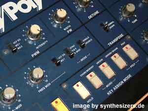

Korg Polysix: (one Osc + subosc) only but a nice "FX" section (chorus/ensemble).. not too fat but ok... those times.. same filters and envelopes like the MonoPoly (SSM) aaand..
polysix is a simple 6voice synth with just one VCO (with sub osc!), later replaced by the 2 DCO- poly61
the specialty on the poly6 is the "FX" section with ensemble, chorus
arpeggiator and chord memory (play a chord by just one key), 1 lfo (mg)
Polysix - the one osc'ed monopoly sister.
but it had a nice "FX" section: means - chorus, ensemble etc.. not really fat.. but nice pads can be done.. no resurrected within "legacy" as one of 3 emulations

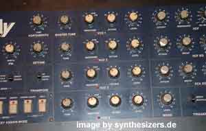

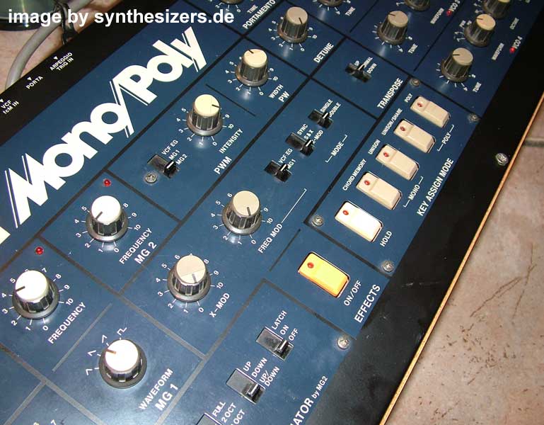

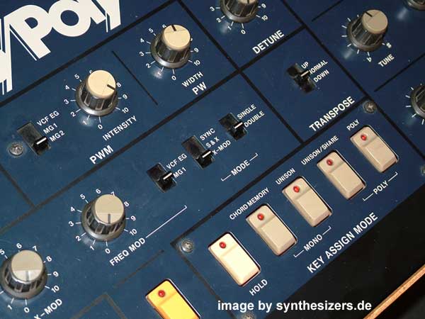

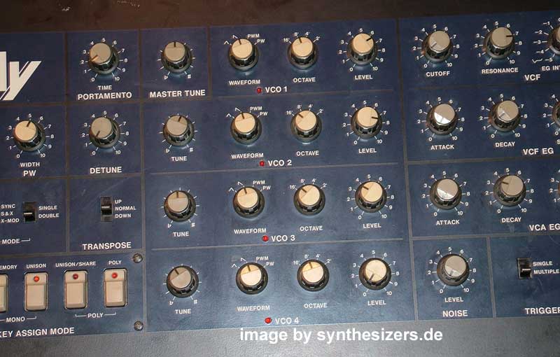

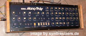

the korg mono/poly is a 4 VCO synth with crossmod (between 2 VCOs) and sync. quite a good bass synth but the env generator is not the fastest on earth.. it was able to be played as a 4 voice polysynth but with one filter only. as the new vermona per4mer (see vermona on this page!) has a similar philosophy but with 4 real synth sections. so the monopoly was used as a faaat bass synth or late "minimoog" competitor (well, it never reached that sound.. but was very interesting)..
SPEEDING UP THE ENVELOPES:
it's been said that korg seemed to have used the wrong pots: they have linear potentiometers inside, if you replace them by exponential ones the ENVs will be much faster!
find some details of the Mono/Poly here (just click the pics to enlarge them)
below: thats, how you can mod the MonoPoly if you don't care about "respect" to design ;) no keyboard.

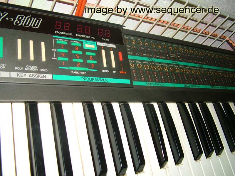

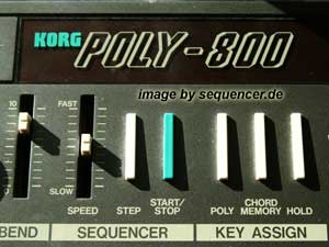

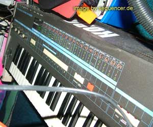

Korg Poly 800 (expander: EX800) was quite similar in programming but with midi. it has 4 voices with 2 VCOs or 8 voices with one VCO higher resolution for resonance and cutoff, standard routings and 3 (!!) ADBSSR envelopes! but: only ONE filter (24dB/oct) for ALL voices!! so any key trigger triggered ONE filter for ALL voices. you can use it with batteries! and it has a nice 256step sequencer on board. (btw: the korg Poly 800 and korg Poly 800 II (a Poly800 with digital delay! built in!) also had one filter for ALL 4 (8) voices!!)
It has a nice set of Parameters for it's 3 ADBSSR Envelops hardwired to Pitch, Filter and Amp.
The Poly 800 II has an extra digital Delay. A rack version is available as EX800. Some poly800 have a nice modification to tweak cutoff and resonance. There are some Poly 800 and Poly800II with inverted keyboard out there.. There is a Sine Wave driven LFO aboard, too.. All versions have a simple 256step Sequencer an board but the note length can not be set.. so it is quite limited.. "nice to have" no more..
Korg Poly 800 Synthesizer
click to enlarge - thanks to acidmoon for poly800 pics!
Korg Poly 800 Synthesizer poly800
The Korg Poly800 is a small 2 DCO Synthesizer. It is 4 note polyphonic when both are in use, 8 notes @ only 1 DCO running can also be used but: You only got ONE VCF for all Voices! It's Waveforms can be used simulatneously at any of its Octave Settings. So it is not bad and sort of "additive octave".. Memorizes 64 Patches.

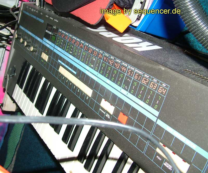

the korg Poly 61 was a simple digital controlled analogue synthesizer, you needed to choose a number from the imprinted list on the housing. same as the poly800. it's resolution for resonace was only 3bit,so its 7 steps only, it's a simple 6 voice 2 VCO,1 24dB/oct LPF, simple ADSR env.- synth with one LFO (called MG=modulation generator on korg synths)
later a Poly61M with midi and a midi retrofit kit was released but quite simple implementation - VERY SIMPLE!!
