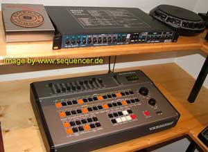

| the current drm mk2 drum module.. | Vermona "vintage" DRM1 : the Vermona DRM1 drumcomputer click to enlarge Vermona drm1, a bit roland CR-like or Korg KR55.. Sound |
