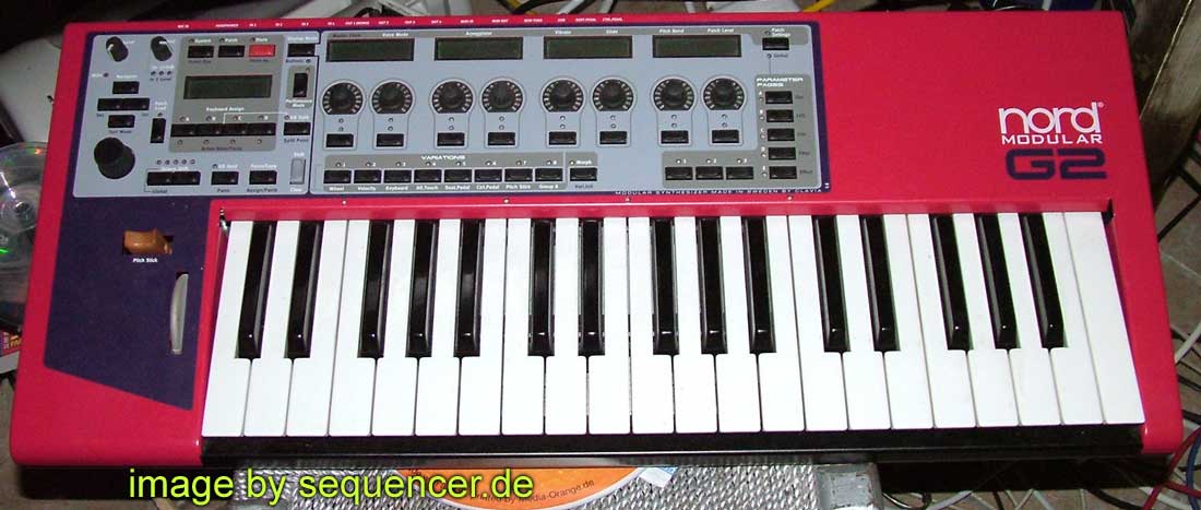

				   the g2x - larger and only available voice expanded plus 2 mod wheels

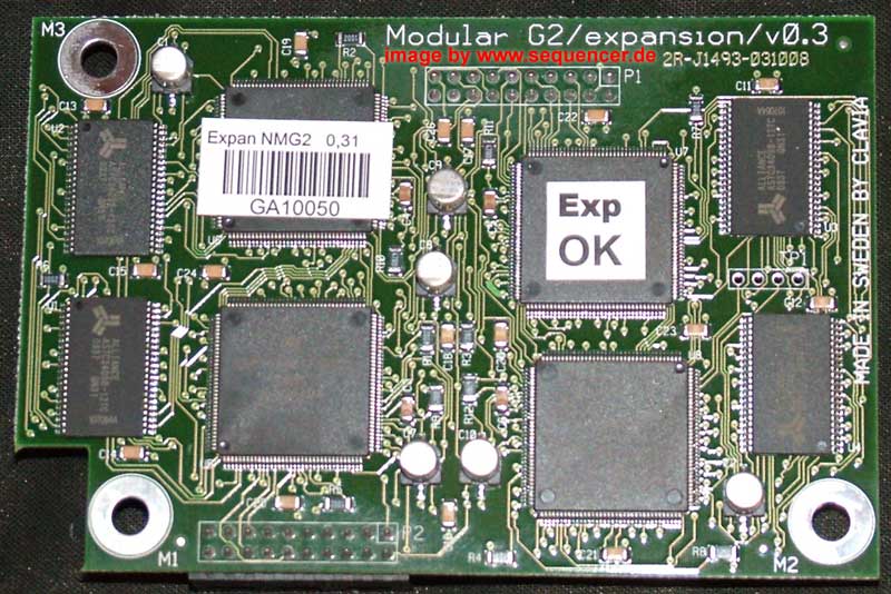

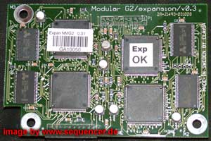

| G2 without expansion | The expansion board.. doubles the voices (32max) | |
| now expanded G2.. click the images to see larger pics.. |  |

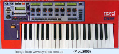

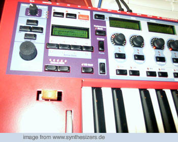

					btw: did you see the changes? the newer g2 has some more buttons and the knobs on the reight moved to the upper left!! these pics are one of my pics I took at the musikmesse frankfurt early 2003. but the proto shown in german keyboards mag shows the above mentioned changes (and nicer colors: blue and cyan instead of grey scales.. anyway.. no real major changes.. there is an arp'er on board!!)

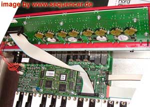

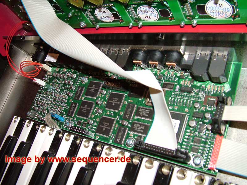

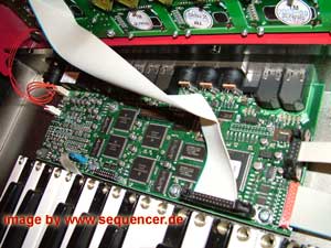

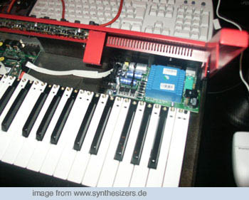

					 the opened G2
the opened G2
