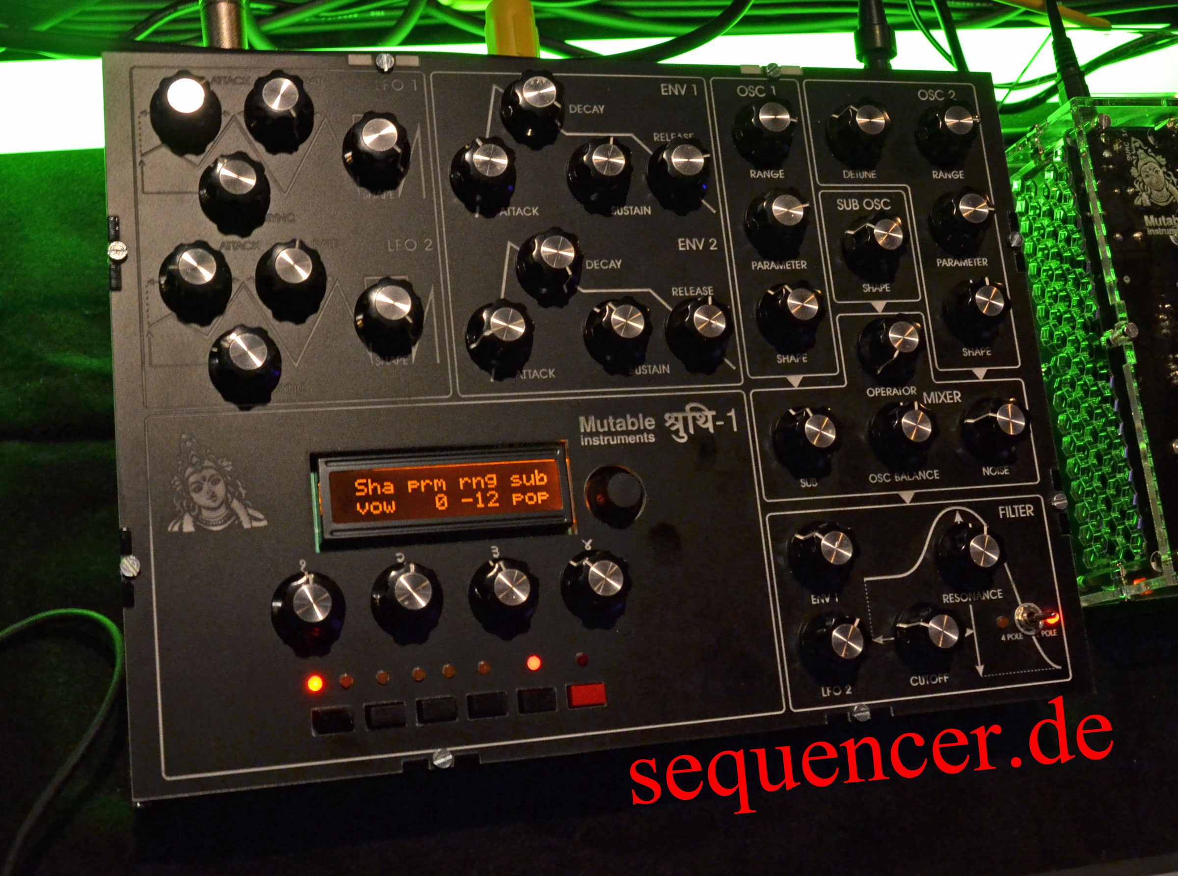

ABOUT This DIY-synth has really spread. It's only available as a DIY kit but it was sold over 2000 times, wow!
the normal Shruti is very small sized.
so the XL was created - the same synth but with knobs for the most important parameters.
the filters are exchangeable, so everyone can choose out of 6 filter concepts.
ABOUT Dieser kleine Selbstbau-Synthesizer ist ein Phänomen. Es gibt ihn bis heute nur als Bausatz, neuerdings sogar als XL Version mit Knöpfen und damit Zugriff auf die wichtigsten Parameter.
Der "normale" Shruti ist etwa 2 Faust-groß.
Es gibt verschiedene Filter, die pro Gerät verbaubar sind. So kann der Nutzer aus 6 Filterkonzepten wählen.

DETAILS there modulation matrix for flexible routings
the lfos got a step sequencer option and they're capable of using the wavetables as shapes as well.
OSC - got multiple options with FM, phase distortion and wavetables - some allow bit crushing as well. incl.supersaw-style stacked saws. Also there are harsher OSC models and a vowel synth
SMR4mkII: 4-pole OTA-integrator LPF
Dual SVF: Two 2-pole multimode filters with serial/parallel routing
Digital filter: Digital emulation of a 3-pole low-pass / hi-pass + a bunch of lo-fi digital effects (distortion, bit-crushing, delay, comb filter)
Polivoks: A clone of the filter of the dark and gnarly Polivoks ; with LP/BP modes ; a switchable distortion, and brutal filter FM feedback
4-Pole Mission: A clean 4-pole based on the high quality SSM2164, from which are derived 15 different filter responses (LP, HP, notch, allpass…) according to a technique popularized on the Oberheim Xpander. Additional circuitry provides 4 different “flavours” of the resonance self-oscillation, from pure and liquid to chaotic and distorted
LP2+Delay: Simple MS20-style LPF and low-fi PT2399 digital delay

SOUND very versatile sound source for everything plus LoFi FX

VERSION there are lots of variations inkl. some with knobs - from a lot of DIYhard users who built one.
officially there is Shruti and
Shruti XL - with knobs
all optional: 6 filter concepts
very individual prices.
