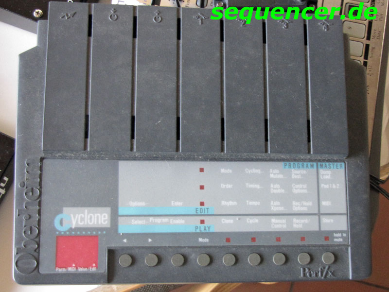

there are 3 standalone Arpeggiators I know of:
1) Oberheim Cyclone
http://www.sequencer.de/pix/oberheim/oberheim_cyclone.jpg
