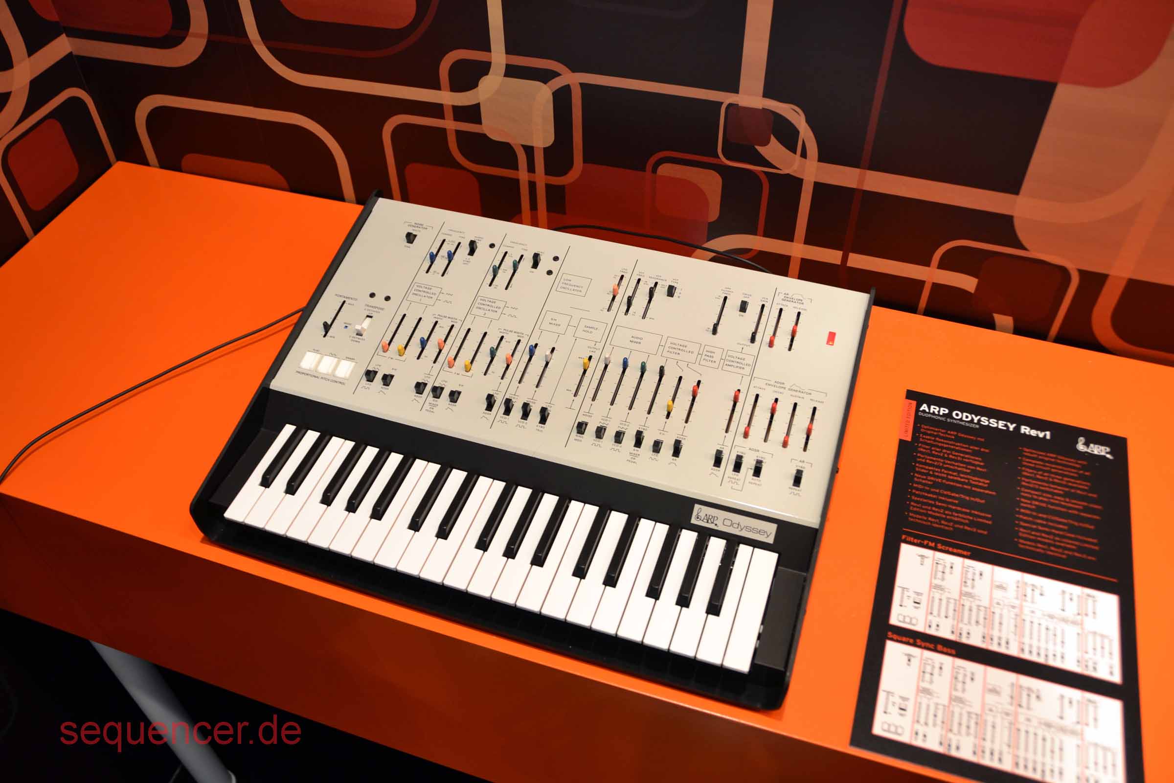

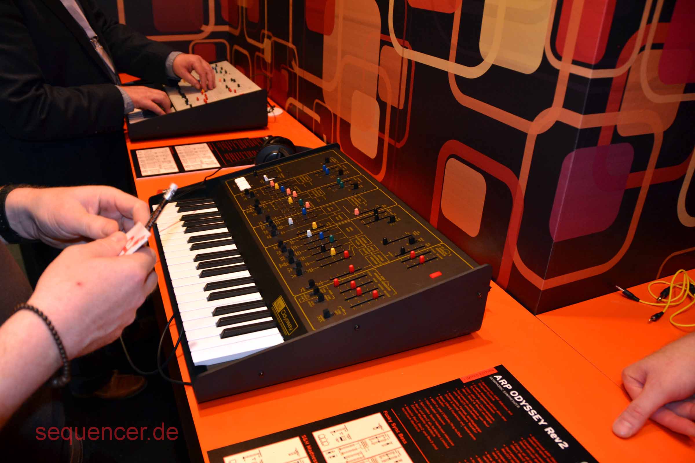

ABOUT Korg cloned the original ARP, made shrunk it to 20% of the original size and gave it the keys known from the Korg MS20 Mini, which are smaller than normal but larger than "mini keys" like that of a Microkorg.
it has USB/MIDI but can only react to notes, so it's simple.
it has a drive switch and 3 filter modes of the 3 important versions:
4075, 4035 & 4023
REV1- white 12dB/oct - early version
REV2- golden Moog infringement-filter version
REV3- orange ARP-filter version (more analytic, thins out more with highresonance)
note that all 3 colour schemes have the same features on the KORG, but not on the original!
4075, 4035 & 4023
