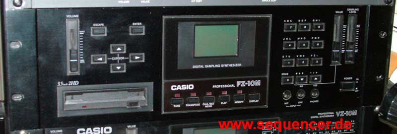

FZ10m
FZ10m rack version = (Hohner HS10m)
FZ10m (rack) FZ10m synthesizer
by: moogulator
FZ10m (rack)
FZ10m (rack) FZ10m synthesizer IMAGE
