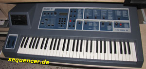

ABOUT The Emulator II was THEEE Sampler, F242 and Depeche Mode used it on stage (the 80ies), most samplers were not much more than this, but more ram.. 3000 were made. quite a lot for that price at its time (in germany 28000 DM = 14000€)
ABOUT Der Emulator II ist wohl der bekannteste Sampler der 80er, F242 und Depeche Mode traten damit auf, er hatte das, was spätere Sampler noch lange kaum überboten. Damaliger Superpreis war gut 28000 DM, HD für nicht-Festplattenmodelle kam für schlappe $3000 ins Haus.

DETAILS very simple sampler from todays view,
basic 128KB ram - 512KB standard
later models,
SMTPE write/read (thats why it was studio standard!).
RS422 mac serial connection for sample editing with sounddesigner (the guys that later were digidesign),
2x 5 1/4" floppy plus version: 20MB HD,2x 512KB
filter: SSM2045, 8bit compressed format (like 12bit)
later models,
DETAILS aus heutiger Sicht ein simpler Sampler mit 27 KHz und 8 Bit (komprimiert, wie 12bit),
SMTPE write/read (wodurch er zum Studiostandard wurde).
RS422 (mac) interface für samplebearbeitung mit Sounddesigner (digidesign!),
2x 5 1/4" floppy,
turbo/plus version: 20MB HD, 2x 512KB
