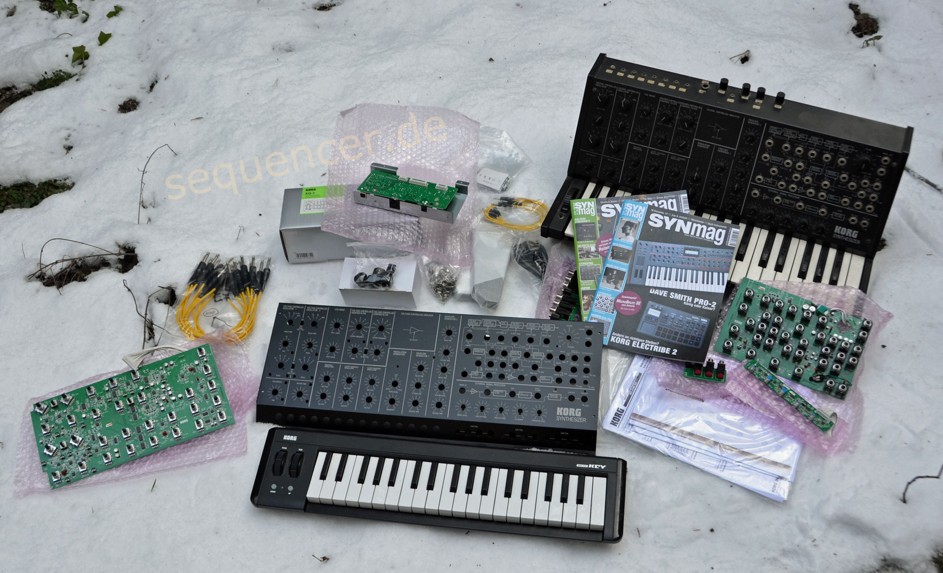

  ABOUT The MS20 as a desktop synth with MIDI / USB with minimal implementation of - note on and off (no more). m is for "module" which means it has no keys (expander) - not meant to be modular since it still is pseudo modular (no access to individual pitch controls or audio components) but you can access a lot more than on any previous MS20:
- Pulse Width Modulation input for VCO1
- FM (OSCs!)
- Sync
- V/Oct. input beside the usual Hz/V.
- 2 Filter Modes Rev 1 + Rev 2
until now the MS20M was available as a kit that needs 2h hrs of screw driving but no soldering and adds the SQ1 sequencer in one box.

	  	  VERSION virtual version: korg legacy analog collection with software based emulation of the ms20.
The MS20 Original is bigger and has 6.3mm jacks.
There are 2 Filter Versions, the later one is a little daughter board with 2 LM13600 OTAs, the earlier one is the Korg 35 "Dual" Transistor, which is in fact 5 transistors..
MS20M und MS20 Mini - newer versions with USB/MIDI
