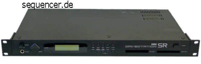

pic shows Wavestation EX Keyboard

ABOUT the Wavestation introduced two synthesis ideas: vector synthesis like the Prophet VS (whose creator Dave smith helped to develop the Wavestaion, VS waves are all in the ROM), the other synthesis idea was to create sample sequences that can be crossfaded called wave sequencing.
ABOUT Die Wavestation setzt an, wo der Prophet VS aufhörte, denn Dave Smith (SCI und DSI) entwickelte mit an der Wavestation, die auch die VS Waves in sich hatte, es gab 4 OSCs, die per Joystick aufgezeichnet/überblendet/wiedergegeben werden können und dazu können ROM samples aneinandergereiht werden zu einer Wavesequence. natprlich bei 4 OSCs nurnoch 1/4tel der Stimmen. (also 8)
ABOUT
DETAILS 16track sequencer and 4MB ROM (M1 ex : 8MB ROM), some FX (2 units) and filters without resonance became studio standard the late 80ies.. 3 complex envelopes (pitch, filter, amp) for 2 layers (thats why it's 2x each env type), extra vector movement envelope. Korg Wavestation - 1-4 vector DCOs that can play samples includes all waves of the sequential prophet VS, with vector envelope you could record the volume amounts of those 4 Oscillators by an x-y axis joystick controlled field. the other big thing here is the WAVESEQUENCE , with wavesequences you can play midisynced lists of samples, that can be edited on the wavestation. its the same samples as those used for the vector synthesis. the filter had no resonance so you had to make a wave sequence that simply plays div. samples that make a "resonant" sound when played sample for sample through the "cue list".. there is a keyboard version, an expanded version called wavestation EX and a nice A/D version featuring a stereo input that can be used to feed the internal FX processor (vocoder inside!but AD only (2 unit 19" or KB)) ! 19" rack (1 unit high called SR) was also available. the samples are all at 32khz sample rate. only the trintiy, triton had higher sample rates.. often compared tosort of a sample based wavetable synthesizer (ppg wave and waldorf wave and microwave series) part of the newer Korg Legacy (analog) software collection and ms20-like controller the wavestation got some resurrection.. ;)
