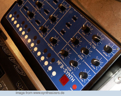

Synth 1
this is a proto in blue, normal colour scheme is black, later MFB synths were blue..
MFB Synth 1 Synth 1 synthesizer
MFB Synth 1
Prototyp in blau
MFB Synth 1 Synth 1 synthesizer IMAGE

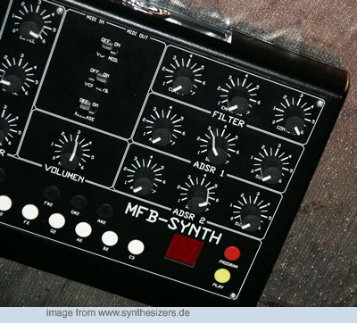

the Envelopes and mod section..
MFB Synth 1
Hüllkurvenbereich

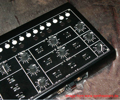

the OSCs and mix section..
MFB Synth 1
Oszillatoren des Synth 1
