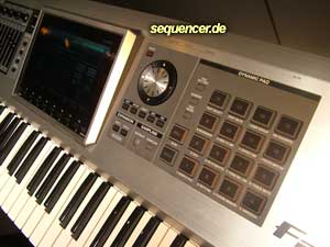

Panel Right: Free Controllers.
Roland Fantom G-Serie Roland Fantom G6, G7, G8 synthesizer
by: moogulator
Panel Rechts, Freie Controller..
Roland Fantom G-Serie Roland Fantom G6, G7, G8 synthesizer IMAGE

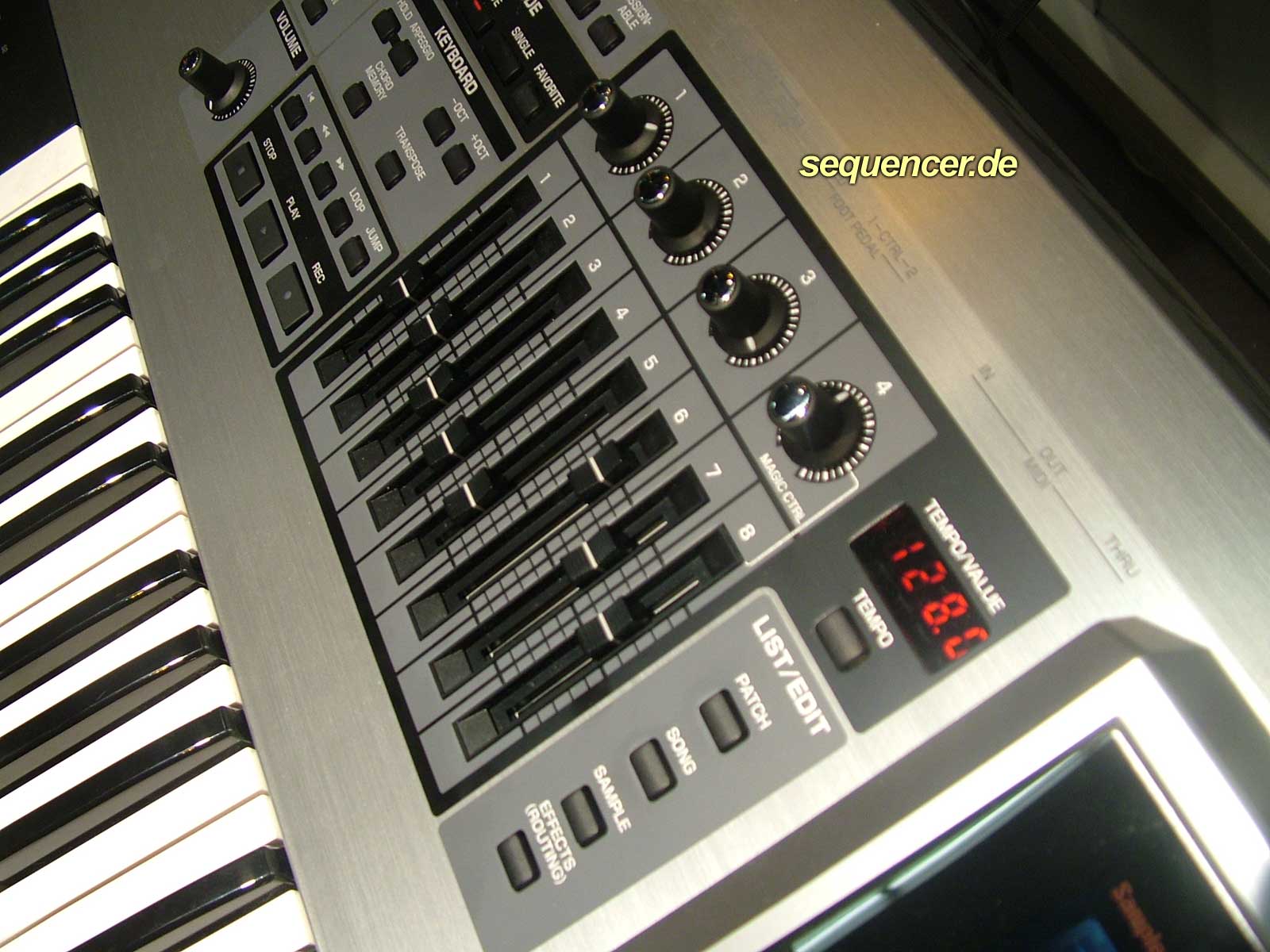

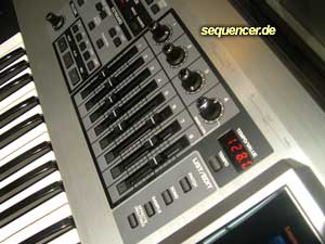

Panel Left: Free Controllers.
by: moogulator
Panel Links, Freie Controller..
