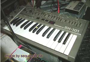

Sh-101
Roland SH-101 Sh-101 synthesizer
Roland SH-101
Roland SH-101 Sh-101 synthesizer IMAGE
