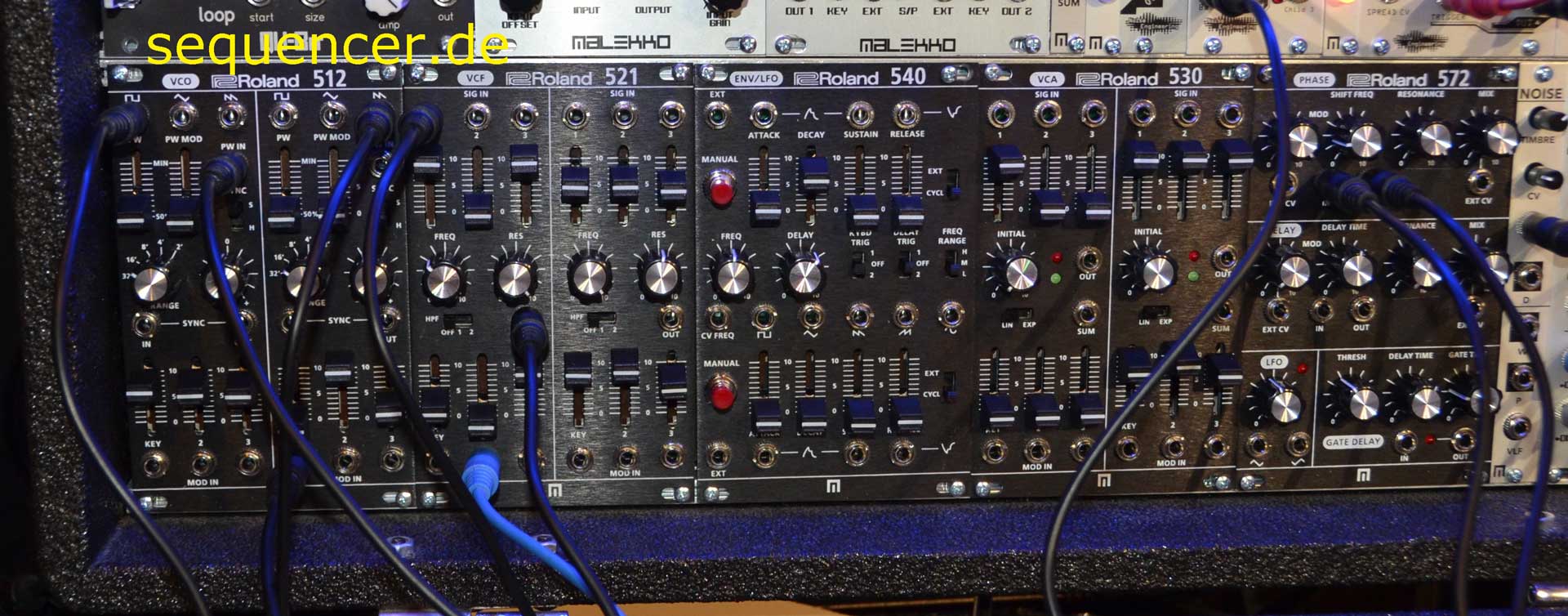

ABOUT Roland and Malekko teamed up to make a new version of the
System 100m
but shrunken from 10cm to 3U eurorack size.
System 100m
ABOUT Roland und Malekko haben sich zusammen gefunden und bringen das auf Musikmesse 2015 vorgestellte Re-Relase des
System 100m als Eurorack-Format.
Sie sind also ein wenig reduzierter. Von etwas mehr als 5HE (10cm) auf 3 HE.
ABOUT
DETAILS there modules have been seen:
512 - 2x VCO's –
530 - 2x VCA's lin./exp
521 - 2x low pass-Filter
540 - LFO & 2x ADSR envelopes
572 - Phase/Delay,with 90° Saw-LFO & Gate-Delay
that's not everything seen on the 100m but those could could be replaced be the Metropolis Sequencer and stuff that is not so relevant being from Roland (for original sound) - well the Ringmod-Module & S/H with noise generator is missing (so far).

512 - 2x VCO's –
Since there is no 4oice assignment this system is in here as "monophonic". That's just the 184 Keyboard of the 100m series that had it all, but there's midi interfaces going up to 8 voices.

SOUND nice FM vocal sounds, fast percussive sounds and interesting FM reso filter sounds. lots of sounds because its modular.
