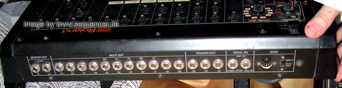

Roland TR808 back
back side: 3 trigger outs, audio outs.. click..

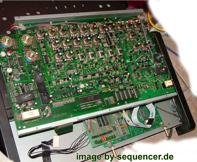

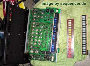

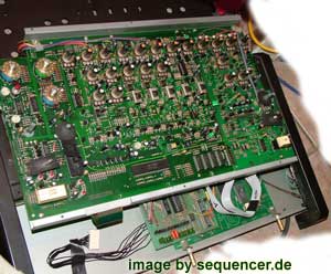

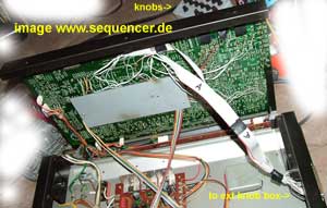

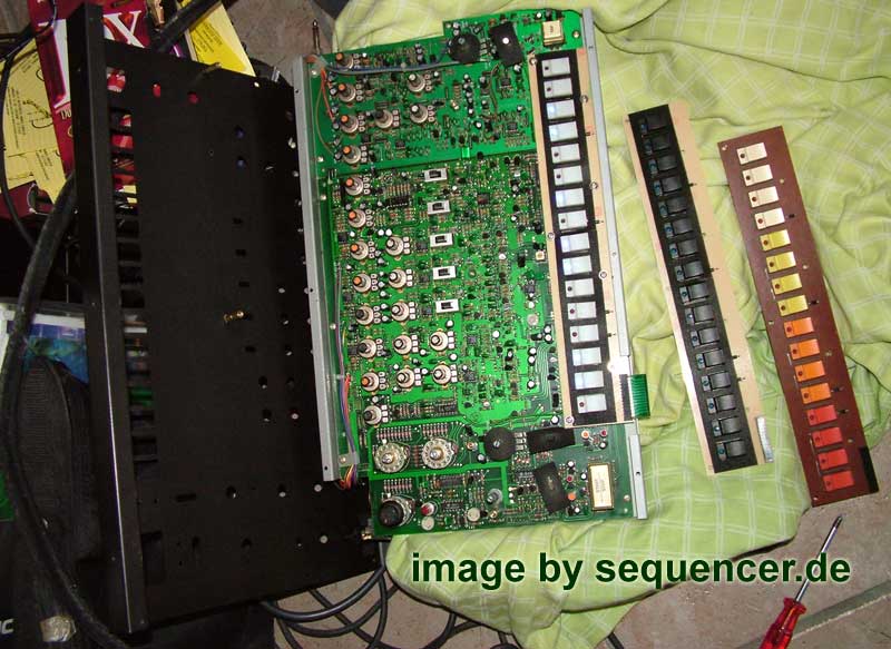

Roland TR808 LED switchboard
Changing the TR808 Switchboard..
TR808 opened..
here's the picture 808 tour..
for our american viewers: do not try this at home - only at YOUR OWN risk ;)

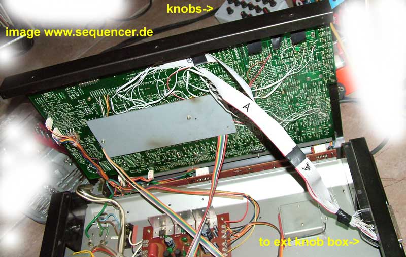

1) remove 3 screws on back and front
2) there are also some screws to remove at the left and right side..

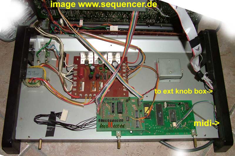

3) now you can remove the control board from the PSU (mine has it's midi interface here also see picture, the big one to the right going to the upper board is going to the knob box! so maybe you do not have it! but maybe you can copy it - just click the pic..)
btw: you can enlarge almost ANY picture by clicking on them!!
4) now remove the knobs and another 3 srews in the middle: one under the big tempo knob, one above the "808"-lettering and another one beside / above the R of rhythm composer..
5) carefully remove the board and leave the cover as is, watch the cables!! the power switch must not be removed but be careful when turning the cover / removing the board..

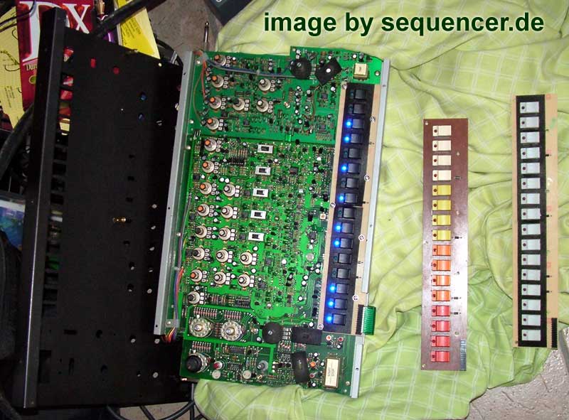

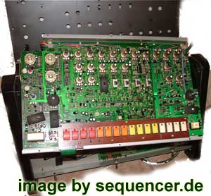

6) when open: you can remove the screw holding the switchboard (right under the switchboard in the front..
7)now the one to be VERY careful: see the flat connection going to the switchboard? .. the 3rd picture shows it already removed: gently use 2 finges on both side to pull it out..
8) you can unsrew 3 more screws now on the board and remove it now.. the 6th pic shows how it looks like ;)
9) see the different boards awailable in the following pictures..
10) now place the board and fix all screws again..
11) how it looks like now.. the last pic and the small "movie"..

the 808 can be equipped with midi 2 ways:
1) a DIN sync interface is built in, there are lots of din sync to midi converters (doepfer,kenton..)
2)send it in and let kenton add a nice midi interface! (see the red button the the right side? it's a midified TR-808 here!)

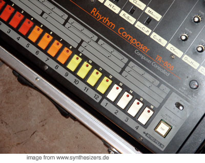

and Jupiter 6 / 8 Buttons..
warning! achtung! the 303 buttons needed to be "slightly adjusted"..
most buttons on 808 and Jupiters do not work perfectly these days. here's a replacement:
---> omron B3F-4000 farnell nr.:176434 für 303 ( B3F-4050 ) F.nr.: 176435

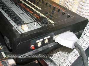

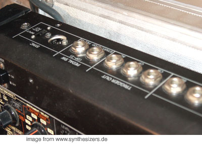

here's the back side of the tr-808
din sync, 3 trigger outs (nice to trigger other analogue gear) and outs for all instruments, master out hi and low level..
and here is the connector and midi in/outs.. (<--pic)

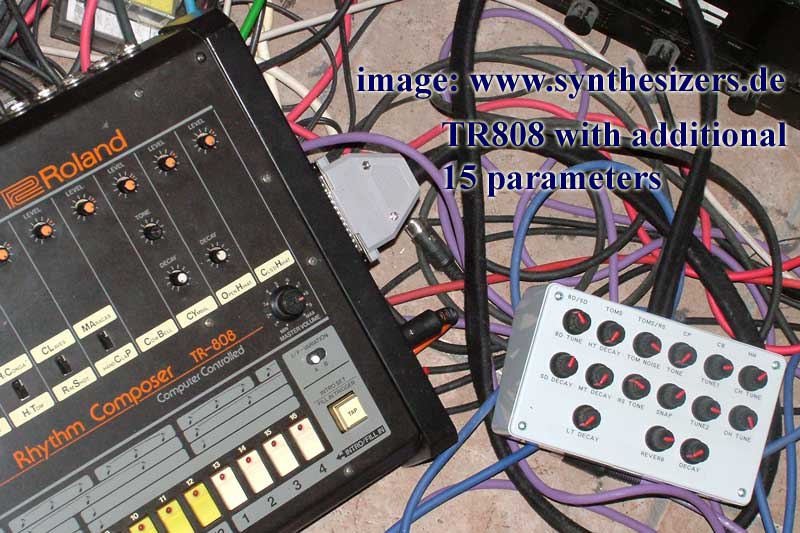

Roland TR808 mod
the analogue solutions - solution: 15 more parameters..
the parameter box is here
it provides BD tune (the real tune!)
SD decay, and lots more.
