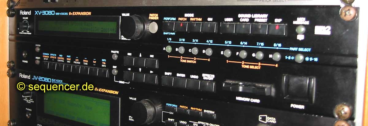

Roland XV3080 synthesizer
pic shows XV-3080 thx hosh

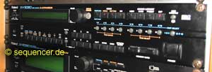

XV-3080 Roland XV-3080 synthesizer IMAGE
