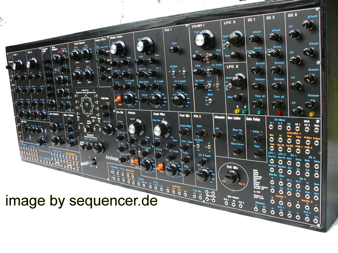

Auralesque (Semi?) Modular System made by Smoo / Olivier Gerber
shown on Happy Knobbing Modular Meeting 2006, Germany
- There are 2-3 Oscillators including Wave Modifiers (let's check the big picture to see it..)
- A Vector Section
- Super Saw kind of Modifier
- Four Filter Sections: incl. Comb
- 3 Envelopes (one CV controlled)
- 3 LFOs (one of them is a very fast one)
- 1 Delay
- All analogue System. One OSC seems to generate Wavetable-kind of stuff.
- Freq.Divider (think of this one as a simulation of SubOscs etc.)
- and Wave Animation Module.

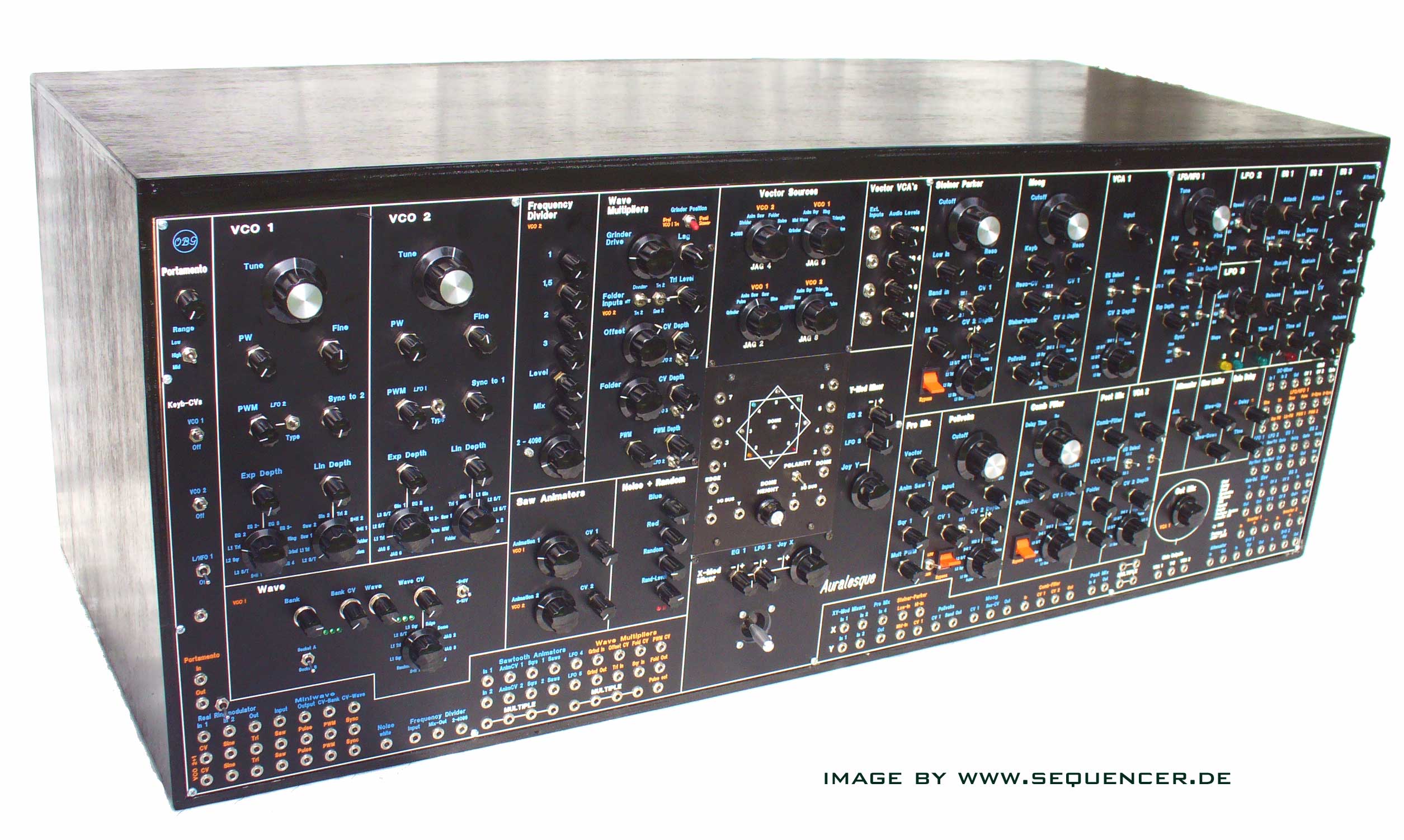

Upper row from LEFT to right: btw: this synth is nothing you can buy for sale, it's unique owned by smoo..
- Portamento: Curetronic "Tool"
- VCO 1 and 2: Oakley
- Frequency Divider: Blacet
- Wave Multipliers: CGS Ken Stone
- Vector Sources: myself Smile. Just 4 Switches
- Vector VCA's with Mixer: Marc Bareilles 4VCA in linear mode SSM 2164
- "Steiner Parker": Papareil Synth Labs and Curetronic
- "Classic Kaskadenfilter 24dB/Oct.": Curetronic "vcf-cv-reso"
- VCA 1: Curetronic
- LFO/HFO 1: Curetronic (its the "3rd" VCO, but mainly used as a LFO)
- LFO2 and LFO2: Curetronic Dual Shape LFO
- EG 1 and EG 2: Curetronic, I added swichable Capacitors.
- EG 3: VC-ADSR from Oakley
Lower row from LEFT to right:
- Real Ring Modulator: CGS Ken Stone (no Pots, its behind the Jacks)
- Mini Wave: Blacet/Wiard
- Saw Animators: Cyndustries (dual module)
- Noise and Random: Doepfer A-100 (!)
- All Vector-Modules: JAG from Wiard, Joystick from Wiard and 2 Mixer-Processors from Blacet (X and Y)
- Pre Mix: Mixer Module from Curetronic
- Polivoks: Papareil Synth Labs! I love it.
- Comb Filter: Analogue Systems (I also used a DC-Mixer from CGS here)
- Post Mix: Mixer Module from Curetronic
- VCA 2: Curetronic
- Attenuator: Just a 100K lin Pot
- Slew Limiter: Curetronic "Tool" Module
- Gate Delay: Curetronic "Tool" Module
- Out Mix: At the moment just a Pot and two Resistors, will change into a real Panner
- Then, there are 3 Multiples and behind the right Jacks is a Midi-Module from Papareil Synth Labs, a Dual Sample and Hold-Module anddual Inverters from *Curetronic and one DC-Mixer behind the Jacks "DC-Mixer".

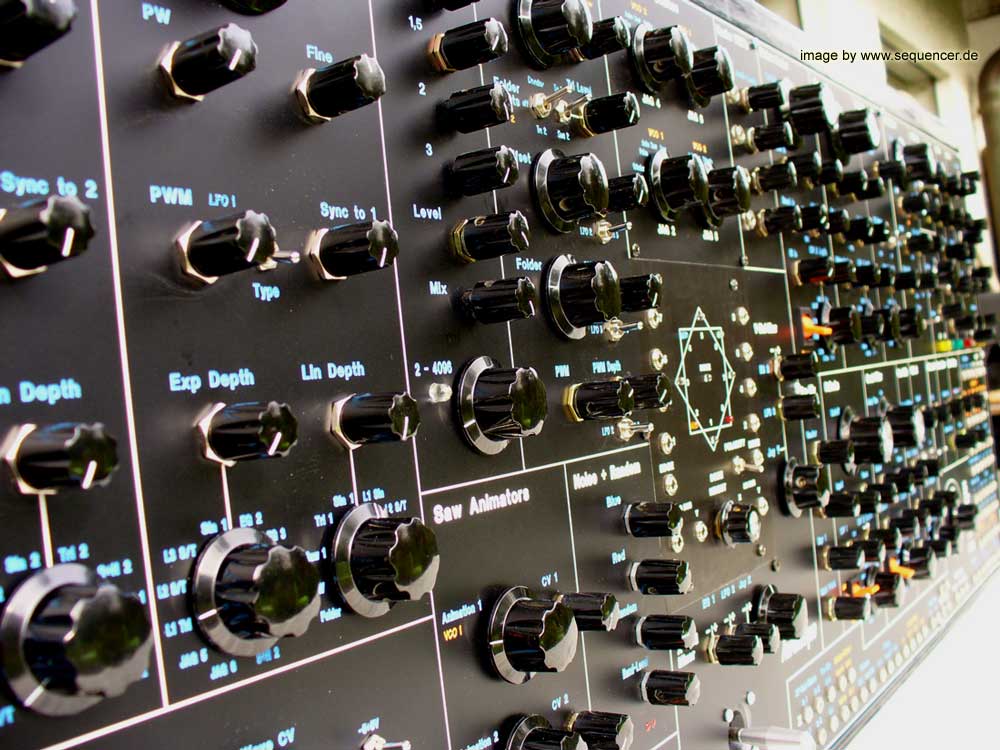

Everything works great so far. I will change the Polivoks Filters IC's from LM4250 to UA776 when I get this IC. I have absolutely NO crosstalk! I used more than 200 meters of wiring behind the faceplate to connect everything to the Jacks AND to the 15 big 12-Step-Modulation switches.
