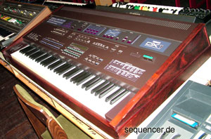

 YAMAHA DX1 Digital Synthesizer
  Yamaha
  DX1
SPECS
Yamaha DX1 synthesizer
shot from bluesynths meeting 2007 Yamaha DX-1
other YAMAHA gear..
Built 1984

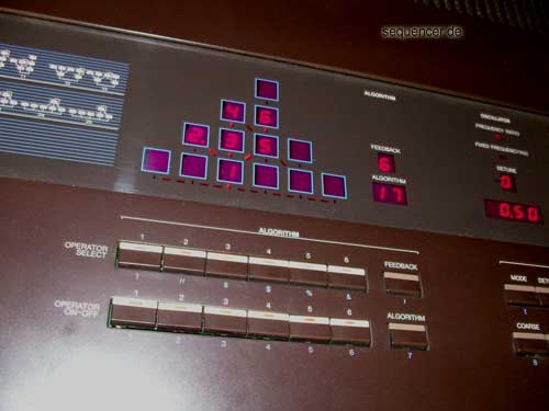

DX-1 FM Synth
very rare but much nice to handle and edit on the box: see the algorithms instantly and play with it! DX-1
Yamaha DX-1 DX-1 FM Synth synthesizer
Yamaha DX-1
Der Yamaha DX-1 mit Steuerung und übersicht der Algorithmen über das Panel, sehr angenehm vergleichen zu den Serienmodellen DX 5, 7 etc.
Yamaha DX-1 DX-1 FM Synth synthesizer IMAGE
