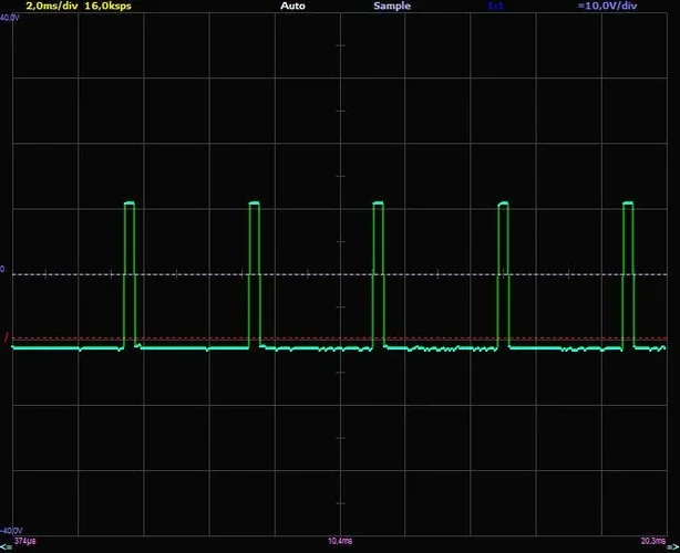

I found bug. :agent:
The resistor R41 should be 1,8K 1%.
The resistor R48 should be 18,2K 1%.
:phat:
This is correct operation of the pulse generator.
So it should look like waveform, the resistor R58.

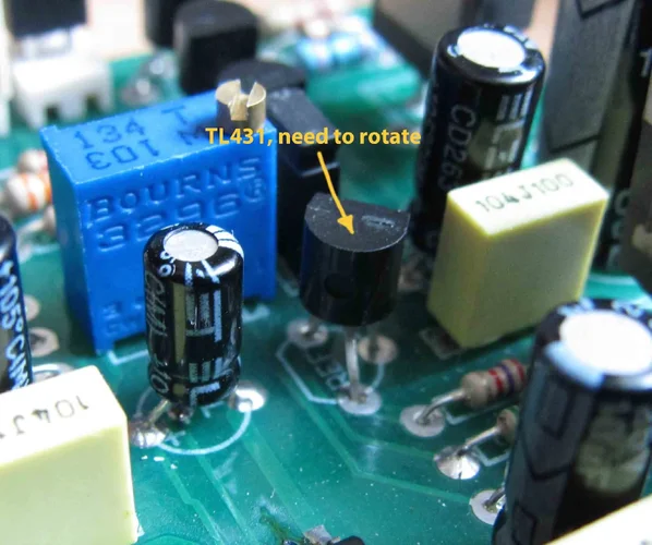

Attention to all who build MIDI to CV converter!
No need to solder a resistor R19.
This can adversely affect the operation of CNY17-3,
and the processor may hang!
The photo shows how to solder TL431, need to rotate.
