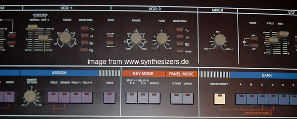

Jupiter 6 difference JP8?
difference ju6 - ju8:
basically the Jupiter 6 and 8 (mks80 rack) are quite close, but the Jupiter 6 has a MULTIMODE FiLTER and of course the Ju-8 has 8 voices whilst the jupiter has 6 and a bit more modulation capabilities:
ju6 has bandpass and high pass filter (multimode filter). more routings, the 8 has a non-modable hpf only. there are more mod rouings on the jp6 and the waveforms can be "added", the ju8 only allows ONE wave per OSC. ju-6 has rudimentary midi (notes and prog change of the "performance" sets, poly mode. if yours only has omni on you can get an eprom at roland to make it listen on ch1 only). ju8 does NOT provide midi. some have DCB (digital but not compatible). there are dcb - midi converters ,but not cheap! in germany ees manufactures them..

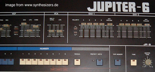

Jupiter 6 ENVs
Jupiter 6 Jupiter 6 ENVs synthesizer

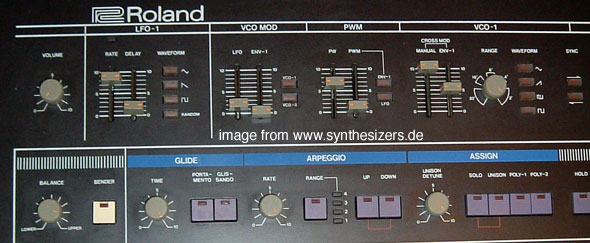

Jupiter 6 VCOs
Jupiter 6 Jupiter 6 VCOs synthesizer
