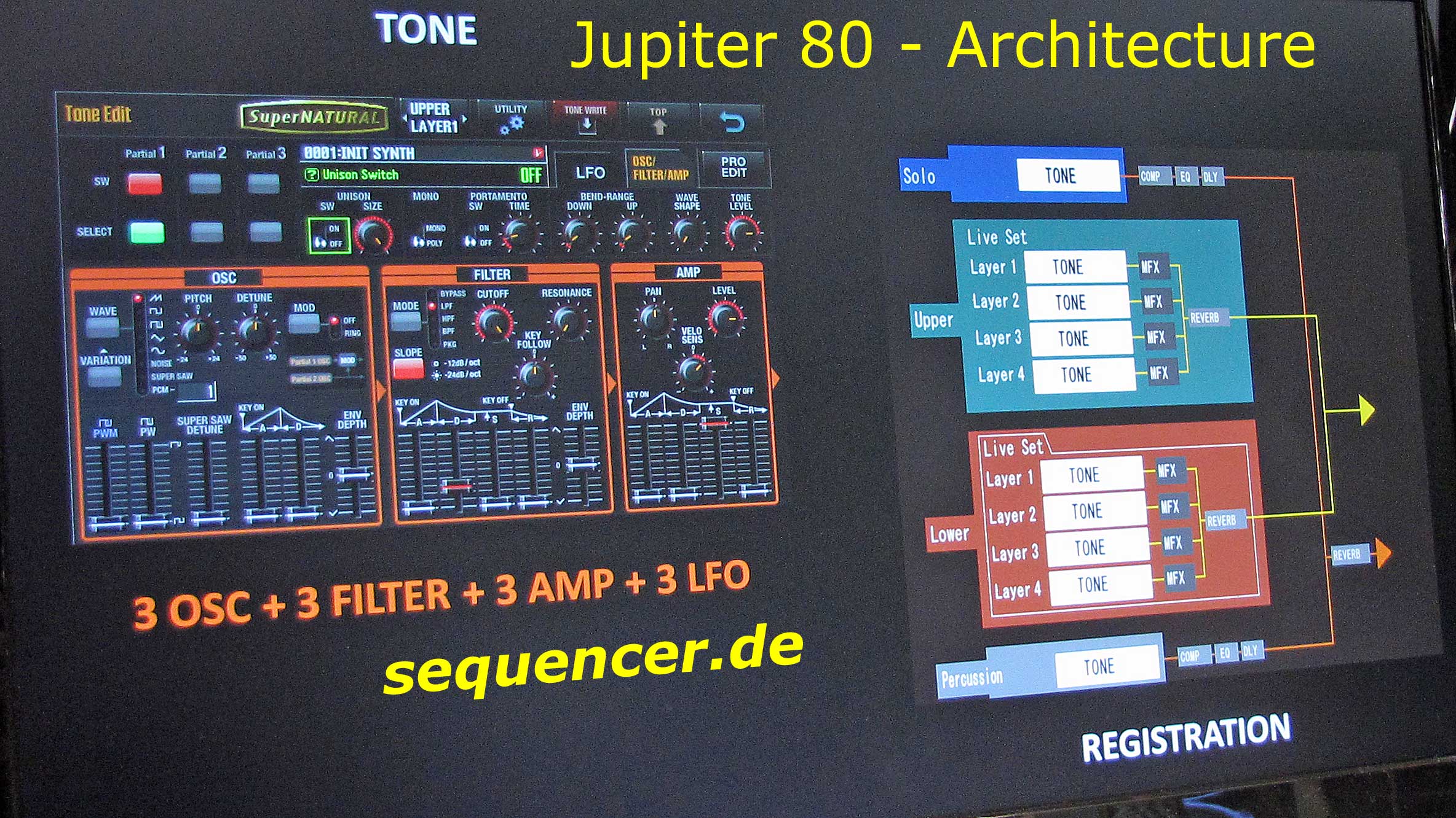

ABOUT The Jupiter 80 is digital and looks a bit like the Jupiter 8 but it's architecture is different.
it has Drums and a Solo Part for more natural behaviour of vibrato (fading in etc) and things like how the sounds behaves when playing notes together - thats what they call supernatural.
the other 2 parts (upper / lower) consist of 4 Tones which are in fact like the Gaia - 3 Partials with OSC-Filter and Amp so it ends up having 3x4 per Section means 24 Layers of OSC-Filter-Amp Synth Parts or so to say 8 Gaias unter the hood but all of them can play Samples not just basic waveforms which makes a lot of pad sounds possible with the JP80

The Jupiter 80 Structure
the Jp80's architecture/nomenclatura
Jupiter 80 Architektur The Jupiter 80 Structure synthesizer
Die Architektur des Jp80
Jupiter 80 Architektur The Jupiter 80 Structure synthesizer IMAGE

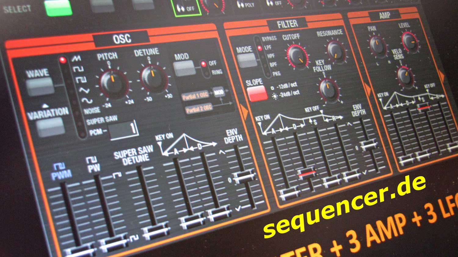

The Jupiter 80 - one Partial
one partial of 3 in a Tone looks like this. Much like the Gaia isn't it?

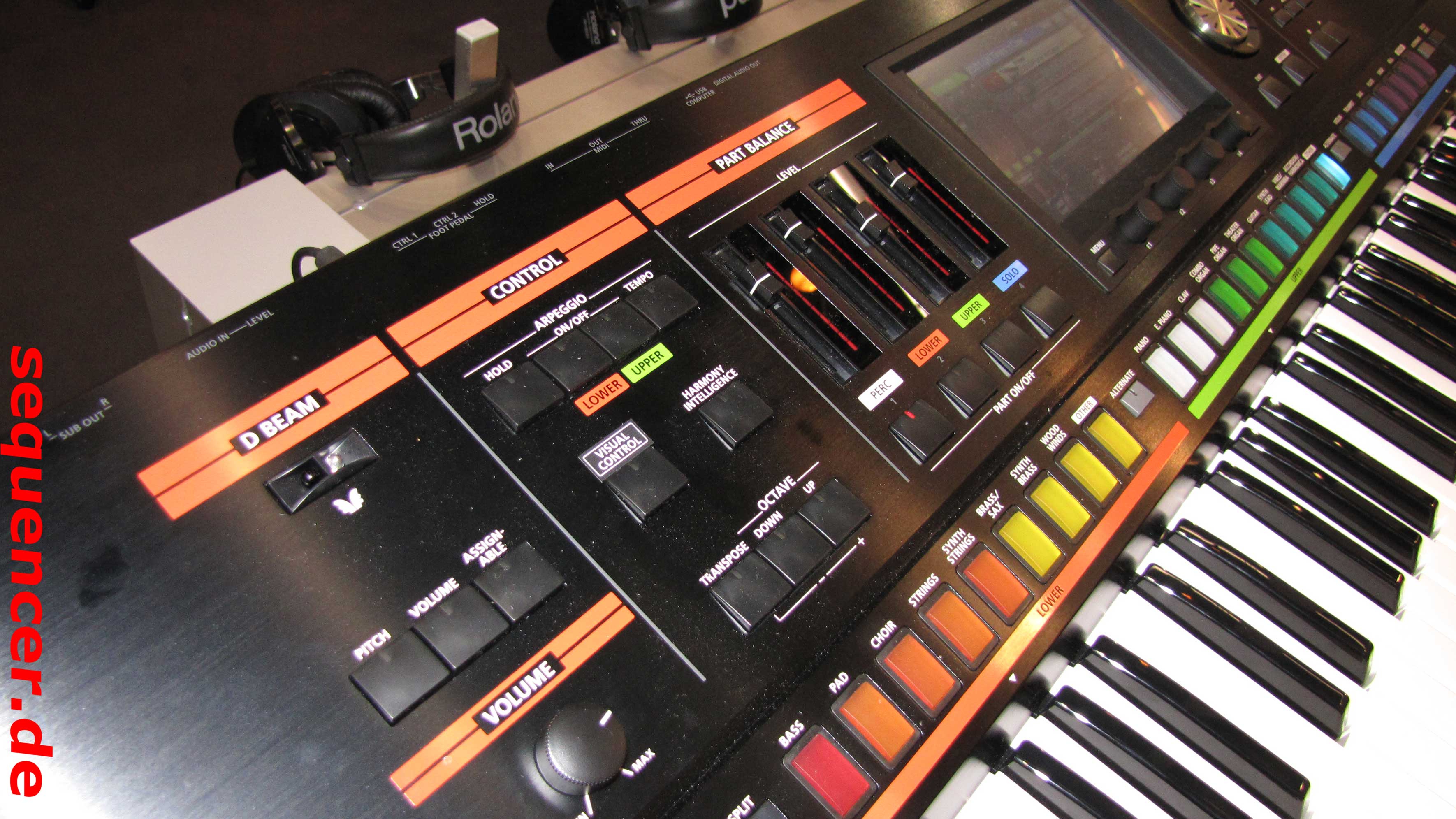

Left Panel of the Jupiter 80
Jupiter 80 Linkes Panel Left Panel of the Jupiter 80 synthesizer
Jupiter 80 Linkes Panel Left Panel of the Jupiter 80 synthesizer IMAGE

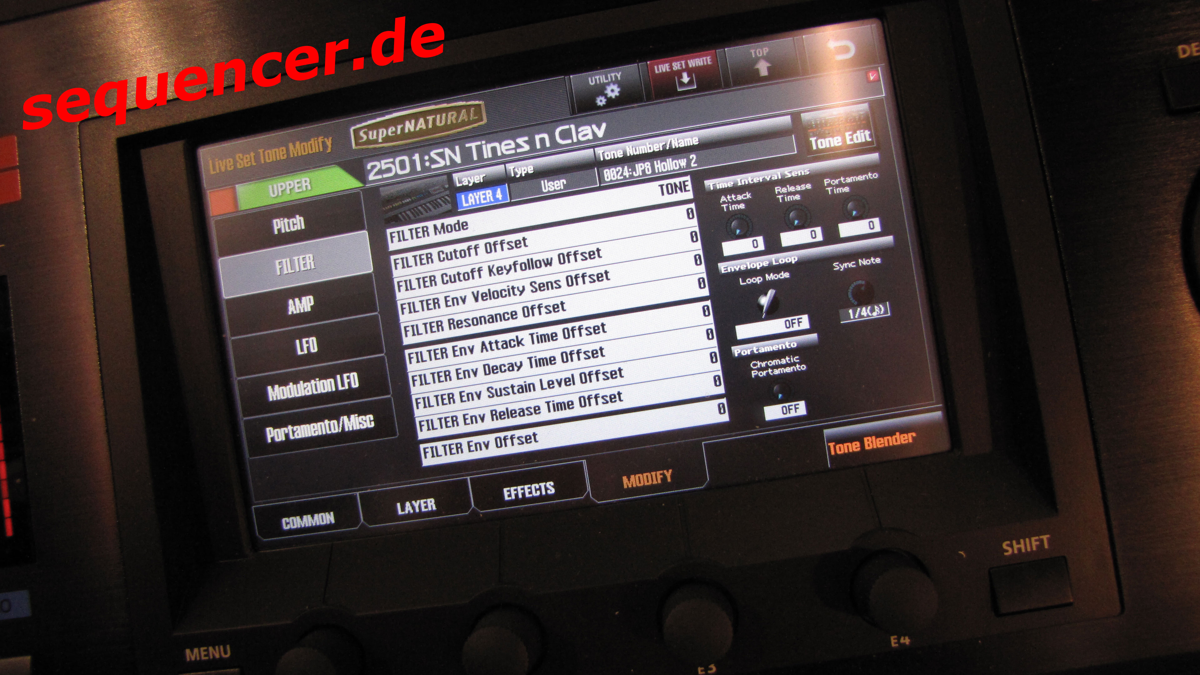

Jupiter 80 display
Jupiter 80 Display Jupiter 80 display synthesizer
Jupiter 80 Display
Jupiter 80 Display Jupiter 80 display synthesizer IMAGE

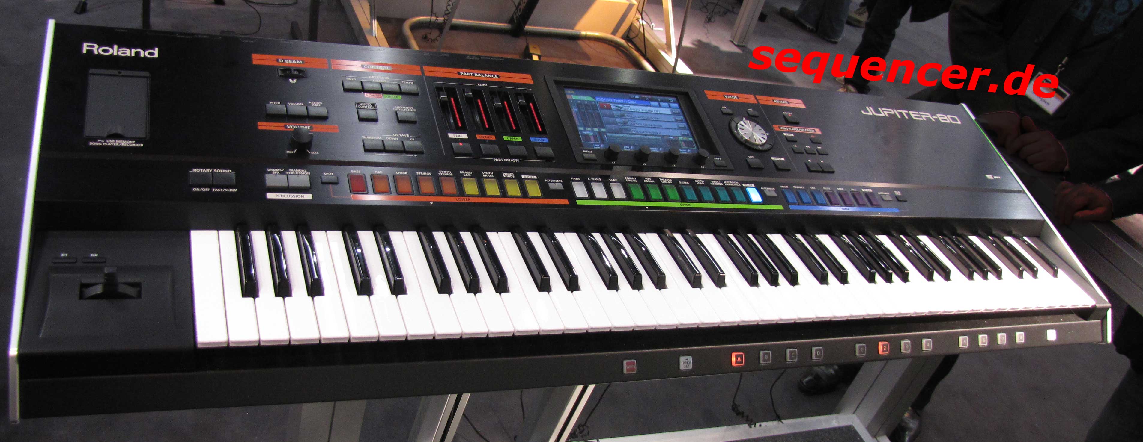

Roland Jupiter 80
Jupiter 80 Roland Jupiter 80 synthesizer
Jupiter 80
Jupiter 80 Roland Jupiter 80 synthesizer IMAGE
