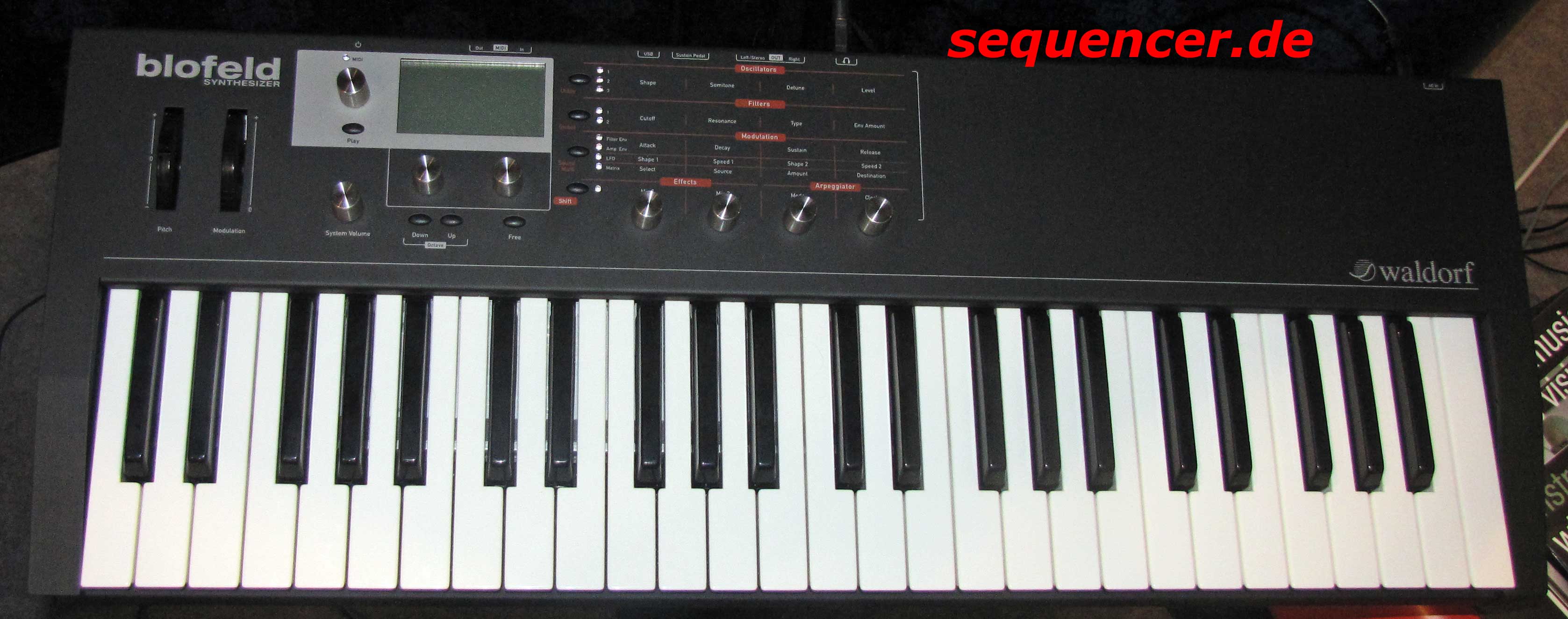

Blofeld keyboard in black
Blofeld Keyboard in schwarz Blofeld keyboard in black synthesizer
Blofeld Keyboard in schwarz Blofeld keyboard in black synthesizer IMAGE
