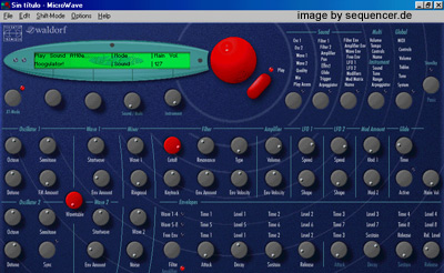

Waldorf Microwave PC

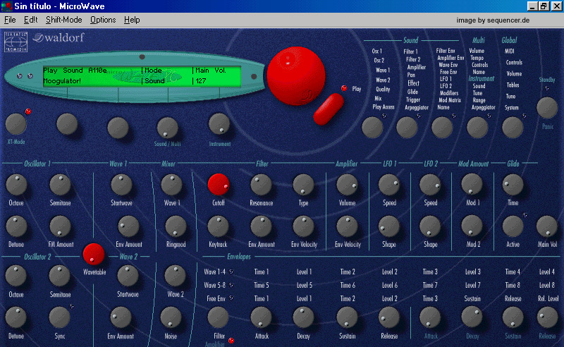

the XT Editor looks very much like the XT (there is a MW2 Mode, too, without the knobs of the XT)..
Waldorf Microwave-PC Waldorf Microwave PC synthesizer
by: Javier Zubizarreta
Screenshot vom Editor, XT Mode
Waldorf Microwave-PC Waldorf Microwave PC synthesizer IMAGE
