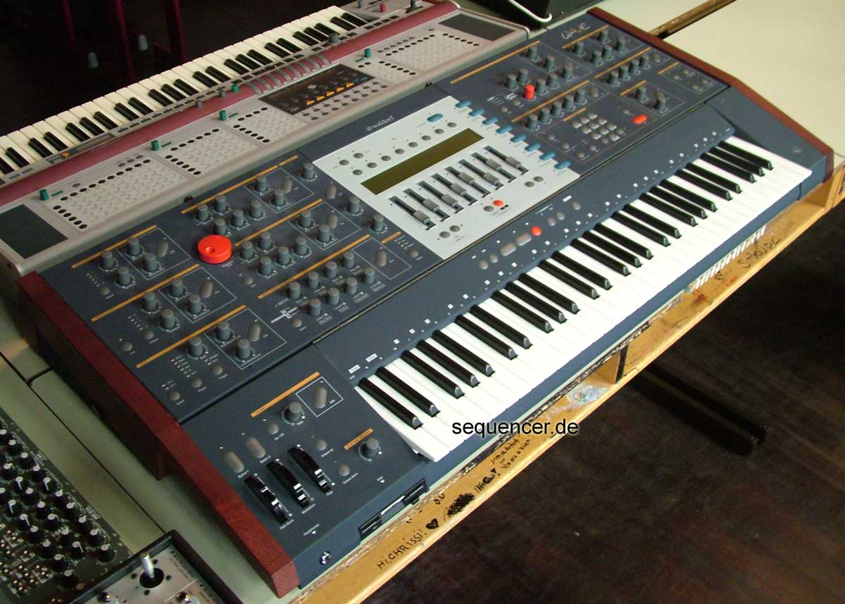

Waldorf Wave
basically the waldorf wave is a microwave 1 with lots of extensions, much more voices and more software ;) :
2 Oscillatorss that are "hybridly" filtered by real analogue filters (whats inside see the CHIPs section).the filter is a 24dB/oct LPF filter with resonance and a 12dB/oct HPF witout resonance.
the wave has the same structure as the microwave 1 but also has some specials like the additional filters, the perfect knob panel and modable "aux" returns.(to go through the filters and pan section, but there is no env follower)
the curtis (filter) chips are rare, so waldorf discontinued the wave. a voice board was worth 2000€ new. 16 voices per expansion. the standard wave has 16 voices, max is 48 voices. but: 8 multis max!
buuut: it really sounds more like a "wall", compared to the microwave, much broader and wider..
it still has one wavetable for both OSCs and can be set independently.
note: like the mw1 it has no sync or fm and the old 3 bit mixer section (7 is max level).
the internal software is able to analyze sound designer files (there is not much software ,that still can handle this format). like sounddiver does for the XT and mw2/mw1 with WAV files it is able to resynthesize up to 60 waves for a wavetable to form a "resynthesis-like" collection of static spectra. now do ,what the wave is made for: scan through the waves using the envelope. you hear some sort of lofi re-assembly of those spectra that form the sound. of course this does not work for all kinds of sounds: noisy or phasing sounds will not give you good results, but some do as a good basis for new sounds and re-construction of spectra.

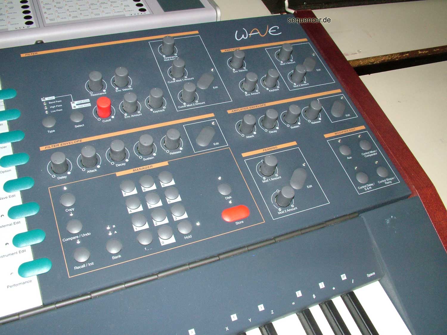

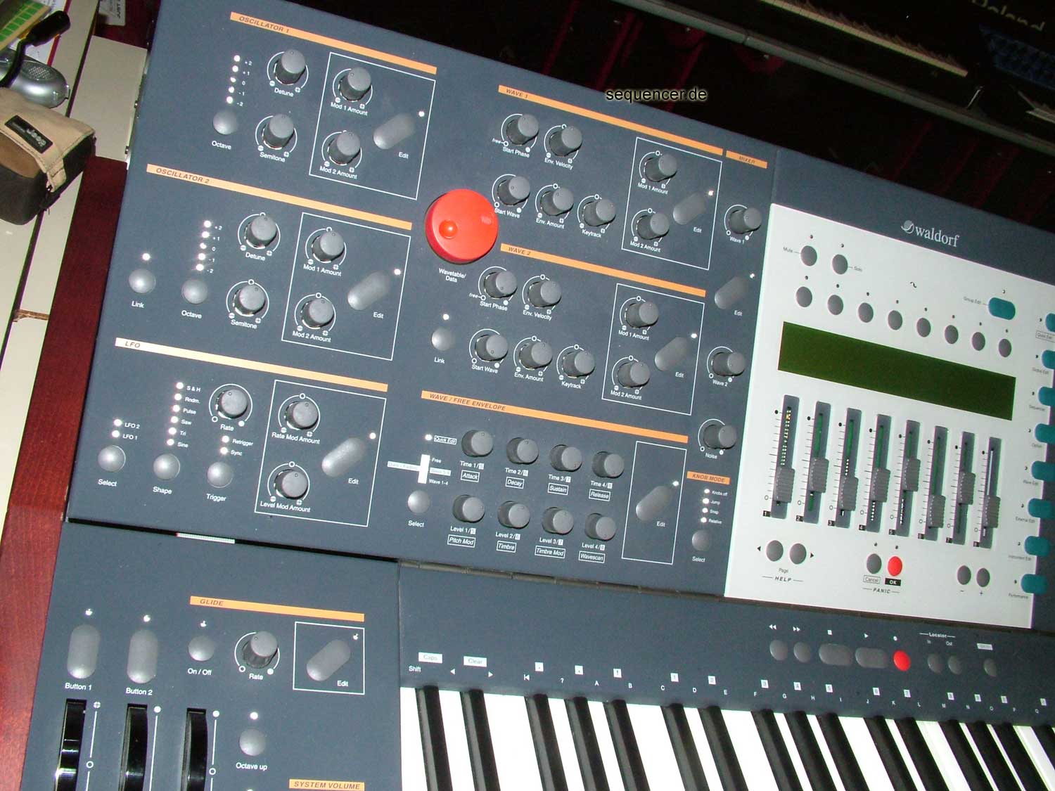

right Panel
Waldorf Wave Waldorf Wave synthesizer
Waldorf Wave
rechtes Panel
Waldorf Wave Waldorf Wave synthesizer IMAGE
Waldorf Wave
left Panel
Waldorf Wave
linkes Panel

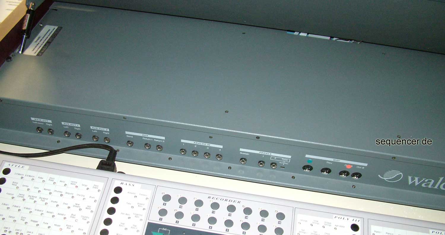

Rear Panel Waldorf Wave
Connect to the Wave, now!
Waldorf Rückseite Rear Panel Waldorf Wave synthesizer
Waldorf Rückseite
Anschlüsse des Wave
Waldorf Rückseite Rear Panel Waldorf Wave synthesizer IMAGE
