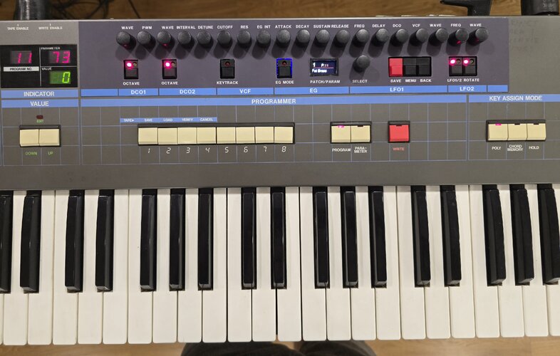

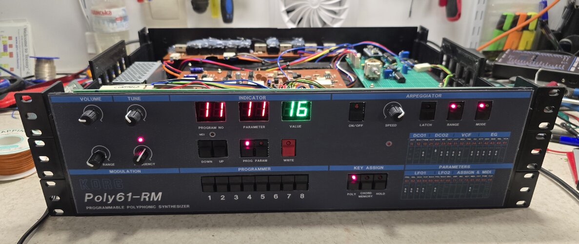

After upgrading my Poly 61's with Tauntek motherboards they were crying out for an editor to exploit the new sonic capabilities. So I built this simple encoder based editor that can store upto 400 patches in memory and exchange them over sysex with the 61 and other editors.
Then I thought it would be better to install the editor into the 61 and use the empty space where the parameters are printed. I then added a Behringer June 60 V2 chorus inside also controlled by the editor.
