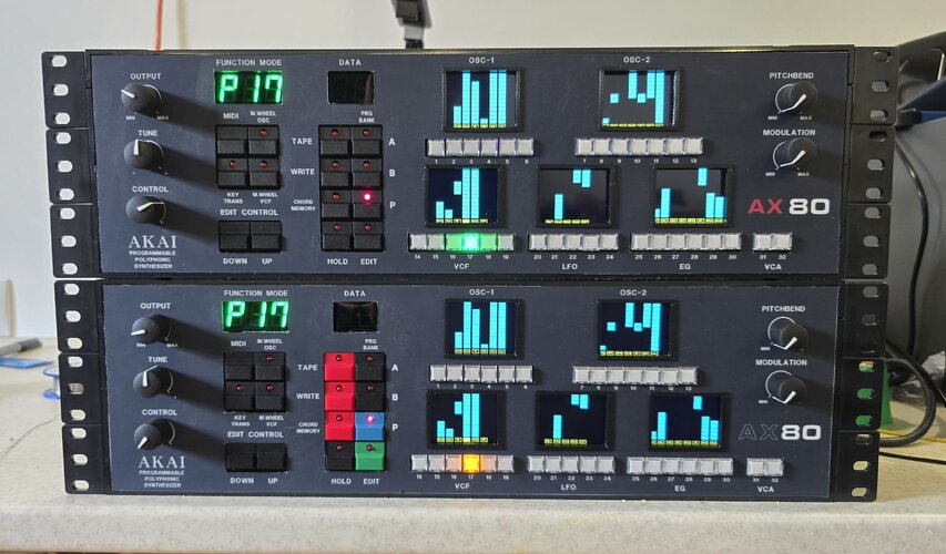

Akai AX-80 rack mount and editor

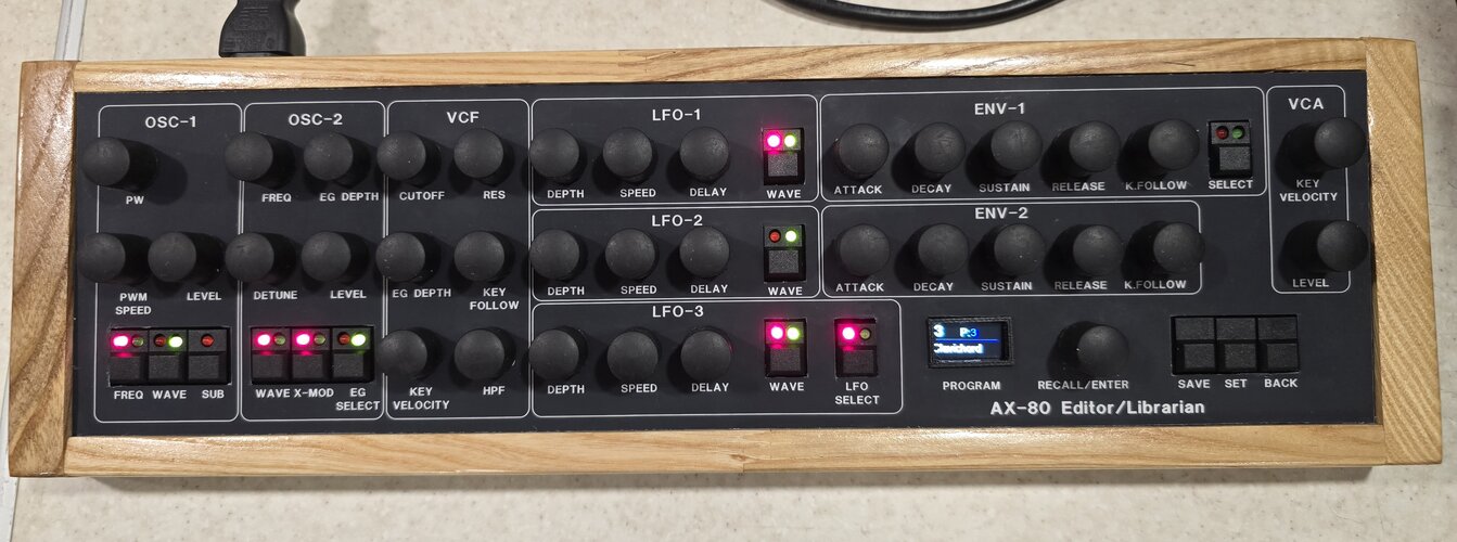

I purchased some boards for an Akai AX-80 and tested them, they worked perfectly with my home made front panel, so I created a set of displays similar to the original in functionality but using 2" OLED displays and added illuminated buttons. Then I decided it needed an editor to unleash the potential of the AX-80 and create interesting sounds.
