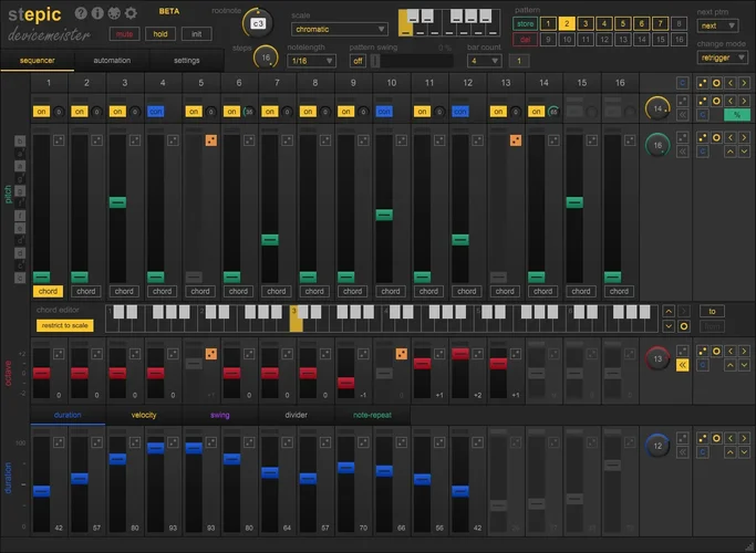

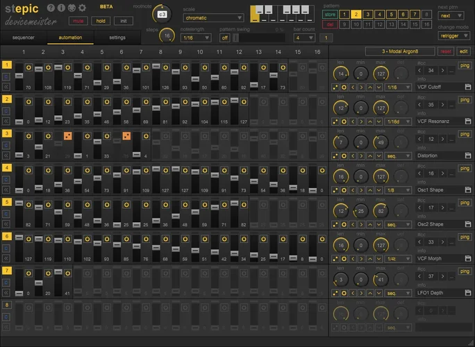

Screenshots:
Notensequenzer
Modulationssequenzer
