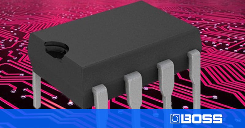

Gibt es irgendwo Quellen mit guten Erklärungen über die Funktionsweise eines BBD-Delays?
Der entsprechende Wikipedia-Artikel ist da eher sehr spärlich:
"A Bucket Brigade Device (or BBD) is an analog circuit contained within a small chip that delays an incoming audio signal. This “circuit-within-a-circuit” was the main reason why an analog delay could fit into stompbox form. The term “Bucket Brigade” is a reference to the technique used by firefighters to put out a fire by passing buckets of water, one by one, down a line. To help explain how delay and BBDs work, let’s stick with that analogy. The water in this example is the incoming guitar signal. The “buckets” in a BBD come in the form of a series of capacitors inside the chip. Capacitors “carry” the signal much like the buckets carry the water. Because the capacitors are continuously filling and emptying, this slows down or “delays” the signal as it takes more time to pass through the BBD."
