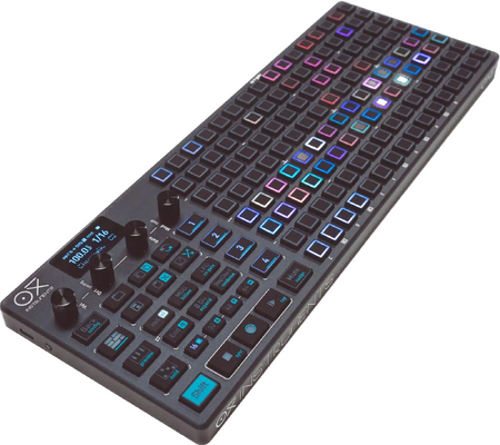

schwarzer OXI One verfügbar und neu 3.7 FW
3.7.0​
NEW​
  • New Random Generator with improved algorithm and new controls:
  • Bias: sets the offset in steps/intervals around which new notes are created.
  • Range: sets the max range (bipolar) in intervals where new notes are generated.
  • Ties: controls the chance of getting TIEs notes.
  • Density can be set from 100% to 1% or to HUMANIZE (randomize Velocity, gate length and micro time offset), randomize PITCH or randomize NOTES ORDER only.
Improvements​
  • Improve synchro between Harmonizer/Follower sequencer and Leader sequencers.
  • Harmonized chord is properly set in Chord mode.
  • Improve pattern synch when switching to Poly mode from any other mode.
  • In Multitrack Up and Down step shifts apply only to the active range of steps.
  • Rework sequencer settings menu in multitrack mode to show the affected track.
  • Add position numbers in the Projects list menu.
Fixes​
  • Fix Arranger not loading the correct patterns on start.
  • Fix Arranger not loading the correct patterns on new Song load.
  • Fix in Matriceal: MOD lanes send MIDI msgs to the correct track's midi channel.
  • Fix GATE Clk issue when getting Note Off events.
  • Fix encoder global MOD lane in multitrack.
  • Fix MIDI Monitor screen exit
