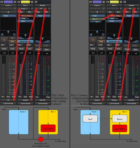

Robin Gareusx 42 schrieb:
Ardour 6 Delay Compensation & Recommendations for Routing
Now that the dust has settled on Ardour-6.0 release, I’d like to point out some details regarding latency compensation.
General rules for routing
  • Prefer aux-sends over direct connections.
  • Avoid one-to-many direct connections (many-to-one is fine).
This article details on why and when following those rules is important.

So let us have a look what happens when those effects are directly connected, using a latent effect as example:
Demonstration of effects of short delays (without latency compensation)
  1. Create an audio track. Its output is automatically connected to Ardour’s master-bus.
  2. Create an effect-bus. It is likewise auto-connected to Ardour’s master-bus.
  3. Add a latent effect to the Bus. This delays the signal passing through the bus.
  4. Connect the track’s output to the effect-bus input (in addition to the master-bus).
Figure 1 shows this as schematic. The direct signal from the track is summed with the delayed signal from the effect processor. Figure 5 below depicts a screenshot of an actual Ardour session with this setup.
Fig.1: block diagram
Fig.1: Example connection diagram showing ambiguous latency though different signal paths; red wire shows the signal path that has been delayed.

The above example shows a situation in which latency compensation is not possible.
This is because there there are two direct connections with different latency connected to a common destination.
The solution to this is to also delay the bypass accordingly:
Fig.2: Delay in the wire
Fig.2: “Delay in the wire” for latency compensation
In order to do this, a “delay in the wire” would be needed, however JACK does not offer that.
This is the reason why one should avoid one-to-many direct connections.

Aux-Sends
This is where aux-sends come into play. Those offer routing that is internal to Ardour, and hence is not constrained by the backend.
As shown in Figure 3, aux-sends in Ardour include internal delay-lines, both for the send as well as the thru path. This allows to handle situation in which case a latent effect is either on the source-track, or the receiving bus.
Fig.3: Schema of internal delay-lines in a send
As an added benefit aux-sends have a separate gain-stage and optionally an independent panner. This makes them generally more useful in most mixing situations.
Aux-sends can be added using the context-menu (right-click) in Ardour’s processor-box.
Fig.4: Adding an Aux-Send

Fig.5: Screenshot of the Ardour Mixer
Fig.5: Screenshot of the Ardour Mixer900×950 107 KB
Fig.5: Screenshot of the Ardour Mixer, showing ambiguous latency due to connections (left) and delay-compensated routing using an aux-send (right)
The possibility to use both direct-connections and sends allows for nonsensical connections (this is also true for analog patch-bays), and situations that can lead to ambiguous latency. In Ardour a warning about this is displayed in the toolbar widget (Preferences > Appearance > Toolbar > Display Latency Compensation Info):
Fig.6: Ardour GUI Latency Indicator
