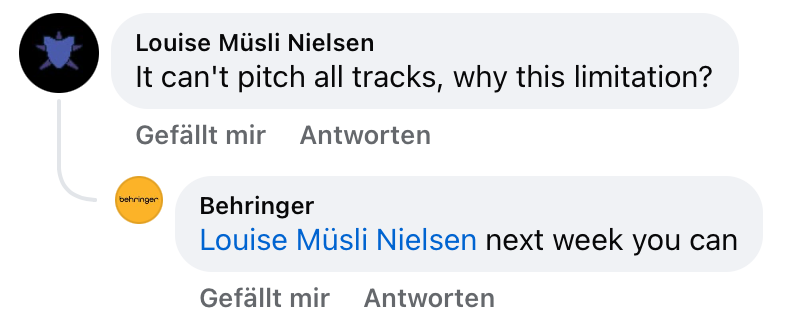

Thank You for the Overwhelming Support for the LM DRUM!
We’re blown away by your amazing feedback and the massive number of orders. Based on our order intake, it’s clear the LM DRUM is becoming one of the most successful products in our history, and we couldn’t be more grateful.
This journey began over four years ago, shaped by your input, and we truly appreciate your support. A special thanks to Roger Linn for his recent suggestion to make all instruments tunable. Our engineers have already implemented it and are testing the feature, with a software update planned for next week.
We’re committed to making the LM DRUM the most powerful drum machine/sampler on the market. This is just the beginning—we’ll continue adding features based on your feedback as we move forward.
Thank you for being part of this exciting journey.
