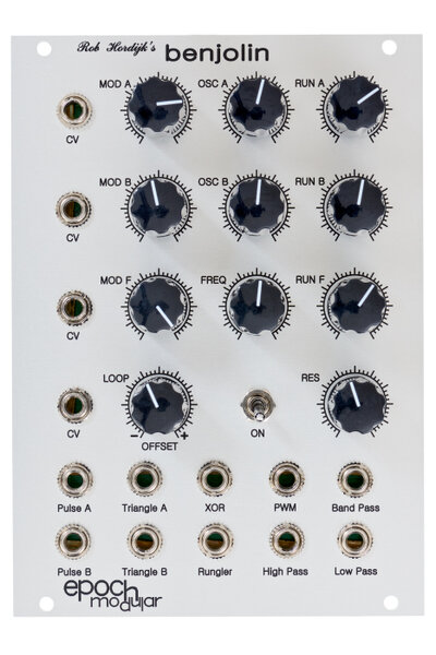

mein absolutes lieblingsmodul, mittlerweile nicht mehr produziert, weil es eine unglaubliche tiefe hat, voller überraschungen & schon für sich allein, ein eigenes instrument darstellt.
die ausgängen der filter haben leider nur line-level, was im modularen kontext manchmal etwas einschränkungen mit sich bringt.
hier die beschreibung von modulargrid:
“Aleatoric Analog Synthesizer
The Benjolinis a multi-function synthesizer designed by Rob Hordijk. The module consists of four separate function blocks: two VCOs, a state variable filter and an additional circuit, invented by Hordijk himself, called a rungler. This particular arrangement emerged from Hordijk’s efforts to design a synthesizer that was, as he puts it, "bent by design". As such, the module functions according to principles of chaos theory, where short to long sputtering patterns spontaneously transform themselves, at times, gradually, at others, quite suddenly, morphing into new pattern doublings and bifurcations.
The chaotic character of the Benjolinis anchored in Hordijk’s rungler circuit. In essence, the rungler is an 8-step shift register that takes its data input from one oscillator (OSC A) and its clock input from the other (OSC B). The output of the shift register is then fed into a primitive, digital-to-analogue converter, creating a stepped voltage pattern of variable length and depth, what Hordijk terms a “stepped havoc wave”. This rungler wave is then wired back into the oscillators, via the attenuator knobs (Run A and Run B), creating the complex interference system that lends the Benjolinits unique, aleatoric character.
The inclusion of a voltage-controlled filter expands these possibilities further into the audio realm. Its design includes Hordijk’s signature, Z-plane modulation circuitry, which produces all-harmonic distortion. This gives the filter that kind of warm, organic character, reminiscent of classic tube amplifiers. This is most palpable when the resonance of the filter is turned to the maximum, with both oscillators running in the audio range.
The filter’s input comprises a mix of a PWM wave (derived from the triangle waves of each oscillator) and the rungler signal itself. As with each of the oscillators, a rungler attenuator (RUN F) allows modulation of the filter as well. To round things out, CV inputs for both the oscillators and filter are normalized, each via their respective attenuators. This allows for cross modulation between the oscillators and a “sweeping” effect for the filter, hitched to Triangle B.“
Die Homepage von epochmodular existiert nicht mehr leider… gibt es aber auf modulargrid gerade viel angeboten, wahrscheinlich weil viele aufs benjolin v2 von afterlateraudio umgestiegen sind!?
https://afterlateraudio.com/products/benjolin-v2
M.i.a.u.: Sekim, Crossinger, Feedback und 2 andere

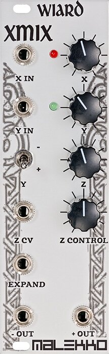

Malekko Wiard Xmix
(sorry - schon wieder ein Modul, das nicht mehr offiziell verfügbar ist. Zumindest so bei Schneiders vermerkt)
Es war eines meiner ersten Module. Kurze Historie: Einstiegsdroge war bei mir ~2012 der Doepfer Dark Energy (erstes Modell mit CEM 3394). Dazu wollte ich ein bisschen extra-Spielzeug, auch angefixt seinerzeit durch einen dreiteiligen Artikel auf Amazona.de. Also ein Doepfer Beautycase besorgt und dann geschaut, was es alles so gibt. Und der Xmix war eine reine Wunderwaffe:
1. 2>1 Mixer (wenn man den Expand-Eingang mit einem davorgeschalteten Abschwächer mitzählt, sogar 3>1)
2. Crossfader (manuell und CV-gesteuert)
3. linearer VCA
4. Waveshaper
5. Gate-Logikmodul
6. Ringmodulator
7. Inverter
Dazu gab es in einem Thread auf modwiggler noch jede Menge Patchtipps. Für mein 32HP kleines Case war das unglaublich viel in 8HP verpackt.
Ich habe kürzlich mein Rack etwas umgebaut. Das Beautycase habe ich immer noch - und inzwischen auch eine geeignete Auswahl an Modulen, um das Case zum idealen Companion für den Dark Energy zu machen (maximale Feature-Erweiterung für den DE in 32HP). Der Xmix ist jetzt (wieder) im kleinen Case dabei und sicher eines der Module, die ich nicht mehr hergeben werde.

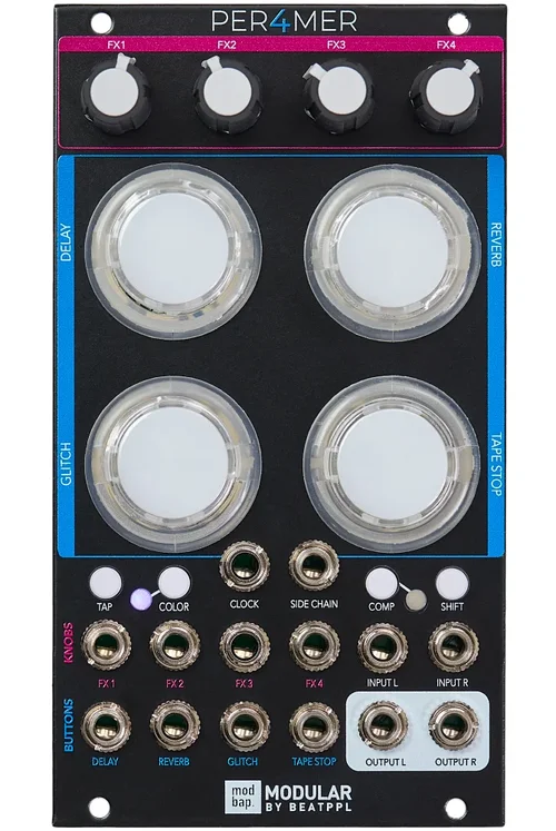

Modbap Perfourmer
Die Anordnung der Buchsen, Buttons und Regler ist zwar total behämmert. Aber wer sein Eurorack live performed bekommt hier einen massiven Mehrgewinn.
Besonders das alle 4 Effekte gleichzeitig genutzt werden können machen unendlich Transitions spielend möglich. Aber auch mit Pitch und Delay lässt sich eine repetitive Sequenz entspannt aufbohren.
Hab 2 davon und überlege ein drittes Modul, wenn auch Winkel Stecker ein absolutes Muss ist.
M.i.a.u.: MvKeinen, Crossinger und Horn

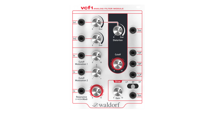

Waldorf vcf1 Analog Filter Modul
Ich liebe dieses Modul, weil es ein sehr gut klingendes Multimode-Filter und ein unglaublich vielseitiger Verzerrer in einem ist. (Das Modul bietet ganze drei Übersteuerungs-Stufen: Regelbare Sättigung pro Eingang, regelbare Distortion für Input 1, regelbarer Overdrive für die Summe.) Dazu sehr ergonomisch gestaltet mit sehr sinnvollem Layout. Leider wurde es von Waldorf nur ganz kurze Zeit angeboten und nie irgendwo richtig beworben. Komplett unverständlich aus meiner Sicht. Inzwischen ist es leider nirgendwo mehr zu bekommen.
Ich nutze das Modul im Moment am Ende meiner Signalkette für Drums, könnte mir aber auch 100 andere Anwendungen vorstellen - unter anderem die Bearbeitung von E-Gitarren-Signalen. Ich hätte auch gerne mehrere davon - geht ja aber leider nicht so einfach.
https://waldorfmusic.com/en/vcf1-overview
M.i.a.u.: Xsample, RustyChuan, Crossinger und eine weitere Person

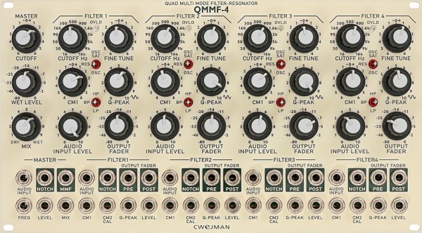

Cwejman Qmmf-4
Habs mir ne Weile überlegt das hier zu posten, weil es so alle 3-4 Monate online Diskussionen über den (Un)sinn von Cwejman Modulen gibt wo sich regelmäßig Leute aufregen die das überteuert finden und da auch recht verbalen Aktionismus betreiben. Grundsätzlich geht es für mich vor allem um die Beziehug die man zu einem Modul aufbauen kann. Das Gefühl das man mit einem Modul hat bzw. das Vertrauen das man hinein setzt. Und wenn ein Modul mir mit jeder einzelnen Betätigung der Regler und Schalter ein Lächeln aufs Gesicht zaubert dann weiss ich für mich, dass es gut ist und rechtfertigt auch jeden Preis. Ich habs mir neu gekauft, was im Gegensatz zu Gebrauchtpreisen wirklich günstig ist. Jeder(!) Regler hat die perfekte Skalierung. Jedes Bauteil (Filter, VCA, Crossfader (Master wet level) und Mixer) sind nach ausführlichen Hörtests das Beste was ich im Koffer habe. Und das ist auch ein bischen das Problem, weil ich in einem kompletten LiveAct Patch gezwungen bin die 4 Filter relativ traditionell einzusetzen. Allerdings sind im derzeitigen LiveAct Set Filter 1-3 relativ interessant eingesetzt. Es sind 2 Leadstimmen, die über den oben beschriebenen Intellijel Scales entweder duophon, diatonisch oder unabhängig voneinander angesteuert werden, d.h. Filter 1 und 3 bilden den Hauptfilter beider Leadstimmen die beide über den internen Mastermixer über das geniale Mungo d0 Delay (kurzes Phasenzeug oder auch rythmische Delay Kaskaden) in dessen Feedbackweg wiederum Filter 2 ist. D.h. ich habe beide Stimmen und deren gemeinsames Feedback direkt nebeneinander und kann das sehr intuitiv bedienen. Der Feedbackpfad wird auch mit einem Env Follower der negativ auf die Amplitude und wahlweise auch auf die Resonanz (Q-Peak) wirkt vom Pfeifton abgehalten. Wenn man sich genau in das Grenzgebiet vortastet dann klingt das fantastisch. Filter 4 ist der Snarefilter mit weissem Rauschen, hier klingt OSC SAT, oberer Schalter mit unterschiedlicher Resonanz mit wechselweise logaritmischer, exponentieller VCA Hüllkurve wahlweise elektrisch oder akustisch. Hier kann ich als Gimmik die Snare ins delayfeedback der Leadstimmen einspeisen oder eben gefiltertes Rauschen. Auch sehr gut als 4 fach Resonator für Vokalartige Sachen.
M.i.a.u.: Horn, SirAdrianFish, Feedback und 2 andere
