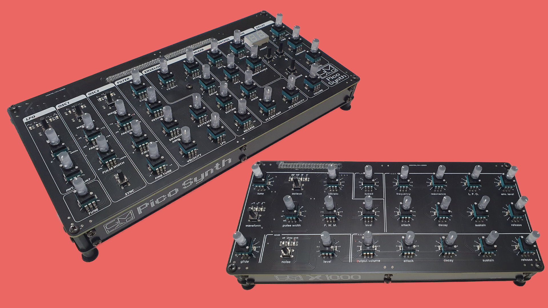

GM Lab X1000 / Pico Synth,open-source synthesizer unter 200€
