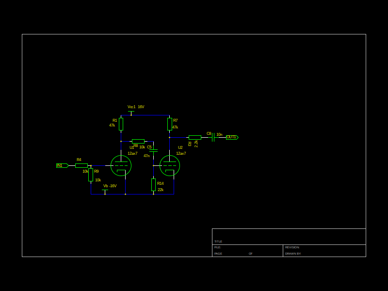

The best way is to split the schematic, we've a input buffer ( or preamp here), a amp (that'S were the non-linearity happen here) and a output buffer (here a passive tone and volume control). So creating 3 circuit's from the circuit above:
BajaTubeDriverp1.sch
BajaTubeDriver.sch
BajaTubeDriverp3.sch
Result:

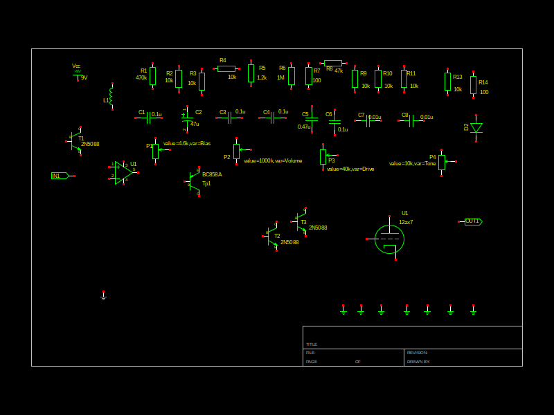

workflow:
Now you could create a circuit with gschem, the geda schematic editor. For easy starting you could open /guitarix-git/trunk/tools/ampsim/DK/gschem-schematics/Startset.sch which comes with a couple of predefined elements you could use to stick your circuit together.

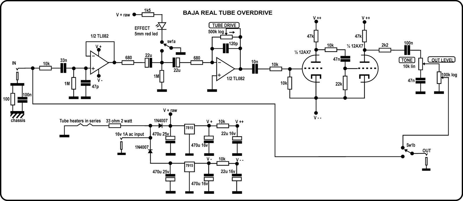

Now, let's say you would create a plugin from this schematic:

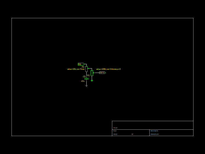

BajaTubeDriver.sch
Result:

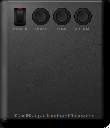

this will create the faust source code, create a non-linear response table (a plot of it will be shown) for the 2. circuit and concatenate all together into one file, and finally build and install the guitarix plugin, which you'll find in guitarix under the "Extern" category.
Check the build-plug-py file for more build options, eg. you could do a frequency plot of a circuit, etc.
Now, say you would create a LV2 plugin from it, run:
Code:
python build-plug.py -i BajaTubeDriverp1.sch BajaTubeDriver.sch BajaTubeDriverp3.sch --table 2 --buildlv2 -n BajaTubeDriver
this will build a LV2 bundle with a X11 based interface and install it to your ~/.lv2 directory, so do a rescan in your LV2 host and you could use it.
