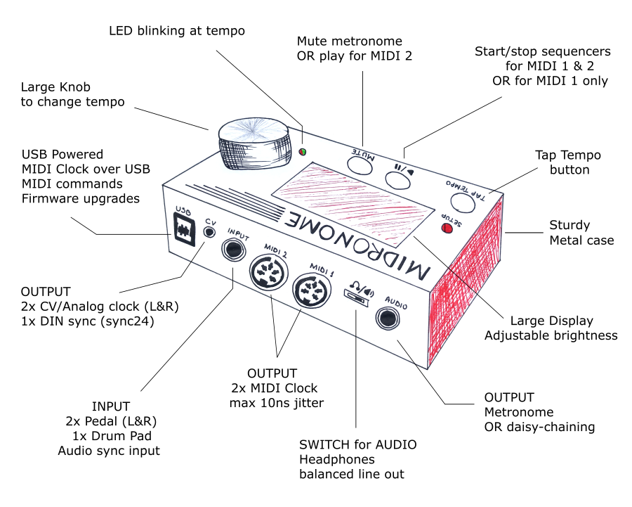

The Midronome is a synchronization device for electronic musicians. It will set the tempo on electronic instruments and solve any sync issues.
Ensure your MIDI gear is tightly in sync with:
  • other MIDI gear
  • the recording software (DAW)
  • acoustic instruments
