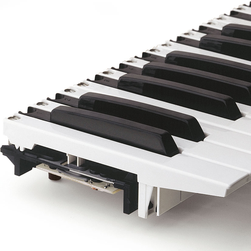

Soweit ich mitbekommen hab gibt es von Fatar das hier
Fatar 37TP/9S Tastiera 37 Tasti con Aftertouch | da NewGroove.it

TM-2: Pro-One Keyboard Replacement Kit
A DROP-IN SOLUTION FOR THE NEXT 30 YEARS Option: add new aluminum knob caps for that exclusive Prophet-5 look The TM-2 kit replaces the old unreliable keybed in any Sequential Circuits Pro-One with a modern Fatar TP/9S semi-weighted one. This is the same keyboard used in many modern synths from...
