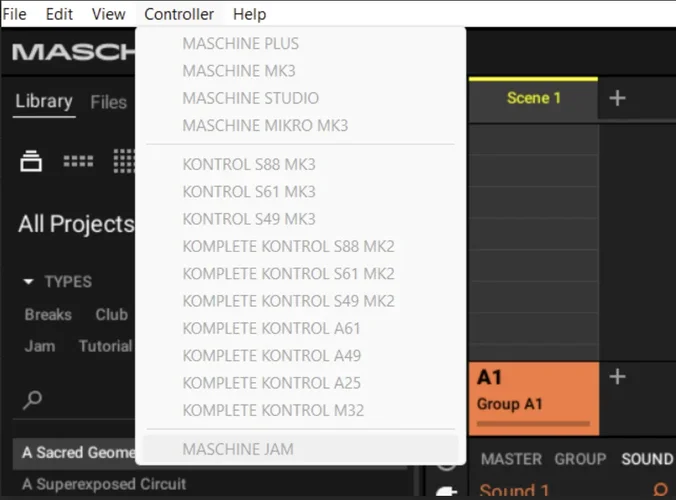

Und was genau rechtfertigt jetzt, dass die MK2 Controller nicht mehr unterstützt werden?

Wie ist das mit den Komplete Kontrol MK2 Keyboards? Werden die von Maschine 3.0 unterstützt?
Ich habe da noch nichts gefunden.
  • #160
Die Kontrol MK2 sind aufgeführt:
Der Grund ist sehr einfach: dafür müssten sie eine komplett eigene Benutzeroberfläche /-führung entwickeln. D.h. unterstützt werden nur noch die Geräte mit den großen Grafikdisplays.

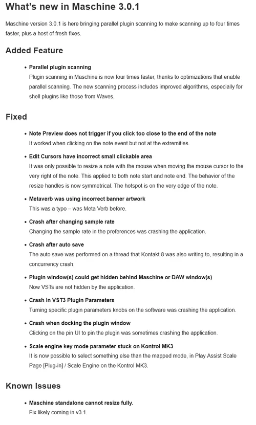

Maschine Version 3.0.1
What’s new in Maschine 3.0.1
Maschine version 3.0.1 is here bringing parallel plugin scanning to make scanning up to four times faster, plus a host of fresh fixes.
Added Feature
  • Parallel plugin scanning
Plugin scanning in Maschine is now four times faster, thanks to optimizations that enable parallel scanning. The new scanning process includes improved algorithms, especially for shell plugins like those from Waves.​
Fixed
  • Note Preview does not trigger if you click too close to the end of the note.
It worked when clicking on the note event but not at the extremities.​
  • Edit Cursors have incorrect small clickable area
It was only possible to resize a note with the mouse when moving the mouse cursor to the very right of the note. This applied to both note start and note end. The behavior of the resize handles is now symmetrical. The hotspot is on the very edge of the note.​
  • Metaverb was using incorrect banner artwork
This was a typo – was Meta Verb before.​
  • Crash after changing sample rate
Changing the sample rate in the preferences was crashing the application.​
  • Crash after auto save
The auto save was performed on a thread that Kontakt 8 was also writing to, resulting in a concurrency crash.​
  • Plugin window(s) could get hidden behind Maschine or DAW window(s)
Now VSTs are not hidden by the application.​
  • Crash In VST3 Plugin Parameters
Turning specific plugin parameters knobs on the software was crashing the application.​
  • Crash when docking the plugin window
Clicking on the pin UI to pin the plugin was sometimes crashing the application.​
  • Scale engine key mode parameter stuck on Kontrol MK3
It is now possible to select something else than the mapped mode, in Play Assist Scale Page [Plug-in] / Scale Engine on the Kontrol MK3.​
Known Issues
  • Maschine standalone cannot resize fully.
Fix likely coming in v3.1.​
Quelle:
