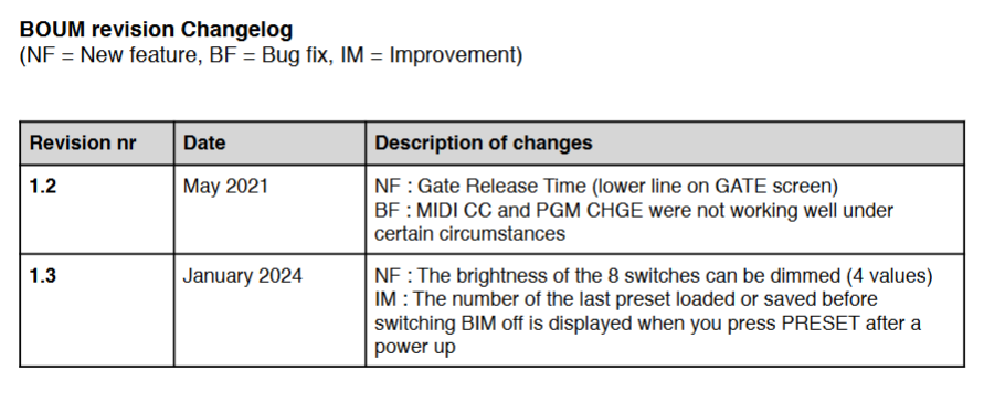

Es gab ein kleines Firmware Update für die BOUM.
BOUM REVISION 1.3 (January 2024)
1. NEW FEATURE :
You can dim the brightness of the 8 switches.
Press RELEASE switch while powering BOUM on.
The DATA pot now controls the brightness in 4 steps.
When you are ok with the brightness, swicth BOUM off and on.
This setting is kept in memory.
The brightness dim function is not applied on the submenus (Display mode, Local mode,
…), the Preset save mode and the MIDI menu.
2. IMPROVEMENT :
On previous revisions the first displayed preset number after startup was always 1.1,
regardless of the last preset loaded or saved before BOUM was turned off.
The number of the last preset loaded or saved before BOUM was turned off is displayed
when you press PRESET after a power up.
This is useful if you want to know which preset was used before BOUM was turned off
Das in den Upgrade-Instructions beschriebene Vorgehen unter Windows mit Midi-Ox, hat bei mir mit Windows 10 nicht funktioniert. Mein Gerät wurde nicht geupdated. Ich hatte noch die Firmware 1.1 drauf. Ein Upgrade mit SendSX Bome funktionierte dann aber problemlos.
