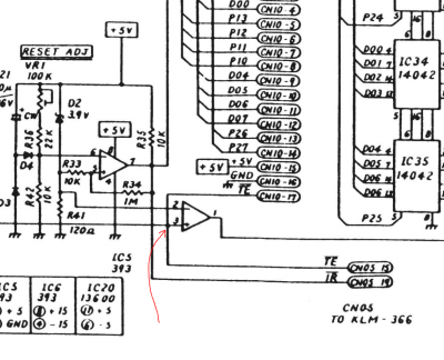

From searching the web I have found indications that it might need a reset. The Service Manual describes a procedure where you connect a 56kohm resister on pins on PCB KLM-376 and you then will be able to adjust PCB KLM-367 and the adjustment will be indicated in the LEDS...? Any input is greatly appreciated :)
Does it boot up fine, if you do not set the tape enable to on?
The reset adjustment with VR1 on KLM367 is something completely different. It has nothing to do with resetting the RAM.

You should definatley check the reset circuit of the CPU.

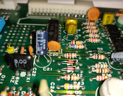

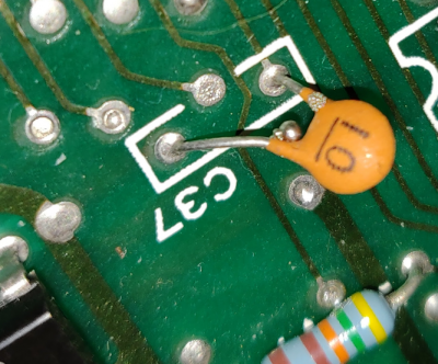

I have found some ceramic capacitors that look suspicious - I can't tell if they are leaking gunk or if they have been glued to the pcb. I suspect them to be bad - see C20 on picture below. On two other ceramic capacitors there where like a tiny drop of metal on one of the capacitors legs...(see C37 on picture below)?

When receiving components I will start by checking the reset circuit from the service manual. Then I will try to follow the path of the "TAPE ENABLE" and exchange IC's along the way. Probably all suspicious ceramic capacitors first.

@PeterSix Well, I think ceramic caps contain nothing to leak, although that crystal stuff in the second picture looks strange, have never seen that before. Also I don‘t believe that one would glue ceramic caps to the pcb. This is most likely some sort edof gunk, but not necessarily emitted by the the cap.
