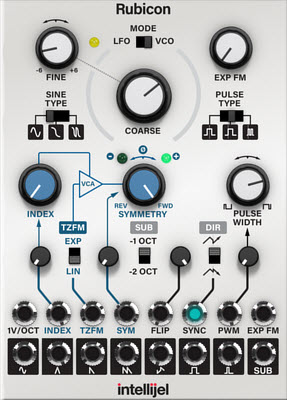

It´s done again! The “Rubicon” tutorial is available (part 10 of my series about Softube´s Modular). With about 95 hours of production time (included some night shifts) it´s got the longest and most comprehensive – so far – tutorial I´ve ever made: nearly 3 hours of explanations, experiments – and some jokes. And it´s not only the most comprehensive tutorial I have ever produces, it is – so far – also the most comprehensive tutorial about “Rubicon” on the Internet (disprove it, if you can :))!
It´s done again! The “Rubicon” tutorial is available (part 10 of my series about Softube´s Modular). With about 95 hours of production time (included some night shifts) it´s got the longest and most comprehensive – so far – tutorial I´ve ever made: nearly 3 hours of explanations, experiments – and some jokes. And it´s not only the most comprehensive tutorial I have ever produces, it is – so far – also the most comprehensive tutorial about “Rubicon” on the Internet (disprove it, if you can :-))!
Timeline
0:00:00 Introduction
0:01:38 The Front Panel: Ovverview and Groups
0:02:15 The Outputs: The Waveforms
0:03:10 The Inputs: Groups of Functionalities
0:04:38 Ranges of Frequencies
0:08:33 The Waveform Switches
0:08:44 Sine, Sigmoid and Double Sigmoid
0:12:30 Pulse, Centered and Edge Aligned, Merging Waves, PW, PWM
0:29:19 Pulse Width Modulation
0:32:17 Softsync (“Flip”)
0:33:48 Terminology
0:34:42 Relations of Frequencies, Master and Slave
0:40:00 Non-Integer Relations
0:41:47 Different Waveforms of the Slave
0:52:55 Different Classes of Spectra
1:16:00 Different Waveforms of the Master
1:18:48 Hardsync
1:20:11 Comparing Hardsync and Softsync
1:24:26 Master-Slave Frequency Relations with Different Kinds of Master-Waves
1:30:14 Rubicon as Master and Rubicon as Slave
1:33:10 The Magic of Zig-Zag
1:35:03 Rubicon-Square versus A-110-Square
1:43:34 SUB: Syncing to Death
1:44:58 Networks of Masters and Slaves
1:46:40 Exponential Frequency Modulation
1:47:05 Just for the Beginners: Some Explanations of Basic Terms
1:48:00 Frequency Modulation
1:49:43 Exponential Frequency Modulation
1:51:42 Linear Frequency Modulation
1:53:07 Through Zero Frequency Modulation
1:58:42 First Exponential Frequency Modulation with Rubicon
2:02:02 Attenuating the Strength of Modulation
2:03:44 Modulating the Modulation
2:07:49 A “Melody of Sounds” with MIDI-Notes as Modulators, Microtonal Scales, Macrotonal Scales
2:10:25 Some Typical Little Patches
2:15:07 Through Zero Frequency Modulation
2:15:25 SYMMETRY
2:20:40 INDEX
2:26:10 And again: SYMMETRY
2:28:17 Detour: The 20% Principle
2:29:40 SYMMETRY and “Negative” Frequencies
2:34:38 “A Singing Modulator” or “Rubicon Gets Rid of Its Voice”
2:46:58 Reflecting Partials and Splitting Partials
2:48:30 Future Prospects
2:51:40 Some Words at the End
The End at 2:52:38

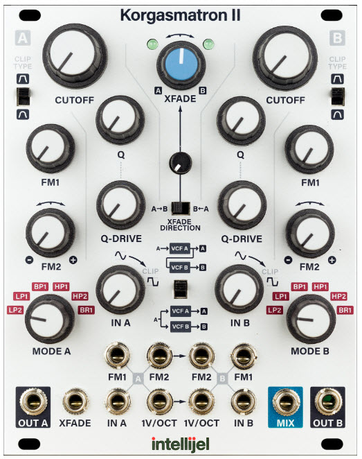

The series is growing and growing: Part 11 of my series of Tutorials about the modules of Softube´s Modular is available now.
Ansehen: https://youtu.be/xVyj9nv4DNs
It´s all about Intellijel´s multifilter “Korgasmatron II”. 2 hours of explanations, examples, experiments and patches (well, only 1 hour 59 minutes and 32 seconds, to be precise). And like always: instead of a lot of words, here is the
Timeline:
0:00:35 The Family Tree of Korgasmatron II
0:01:40 The Overall Architecture and the GUI
0:02:16 Internal Signal Paths (A and B), Part 1
(incl. Seriell Mode and Parallel Mode)
0:08:44 XFADE
0:12:56 Seriell Mode
0:16:15 XFADE Modulations
0:21:35 Cutoff Modulations
0:24:20 Internal Signal Paths (A and B), Part 2
(incl. FM2)

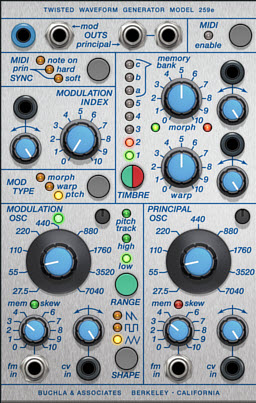

“Softube Modular the Tutorials part 12: the Buchla 259e unit” is available now:
Ansehen: https://youtu.be/fNMA_91xRxQ
2 hours and 40 minutes (and 54 seconds :-) ) full of explanations, demonstrations and experiments. Probably the most comprehensive guide to this twisted, crazy and complex west coast module you will find on the web (so far, 3 March 2018).
Content and Timeline:
0:00:40 Buchla and Moog, West and East
0:01:22 Are They Crazy In California?
0:02:10 Basic Structure
0:03:33 The Principal Oscillator
0:03:38 Frequencies and Pitch
0:04:23 FM and CV Modulation, Similarities and Differences
0:14:08 MIDI
0:26:30 Green and Red Wave Shapes
0:28:30 Morphing Wave Shapes
0:29:39 Warping Waves
0:31:00 Modulating Morph and Warp
0:42:08 The Wave Shapes In Detail
1:24:35 The Waves a, b and c or: “How to Drink the Attic”
1:28:20 The Memory Skew Mode
1:50:05 The Modulation Oscillator
1:50:54 Modulation Shapes and Frequencies
1:55:25 The Pitch Track Mode
2:05:00 Modulating the Modulations
2:15:52 The Modulation Types
2:17:27 The Modulation Index
2:19:45 Softsync
2:26:45 Hardsync
2:29:34 MIDI Sync
2:31:23 AC Coupled Outputs and DC Coupled Outputs
2:34:55 Buchla 259e, The Hardware and the Software: Differences
2:37:25 Some Words at the End
2:40:54 The End
Enjoy your day!
Rolf

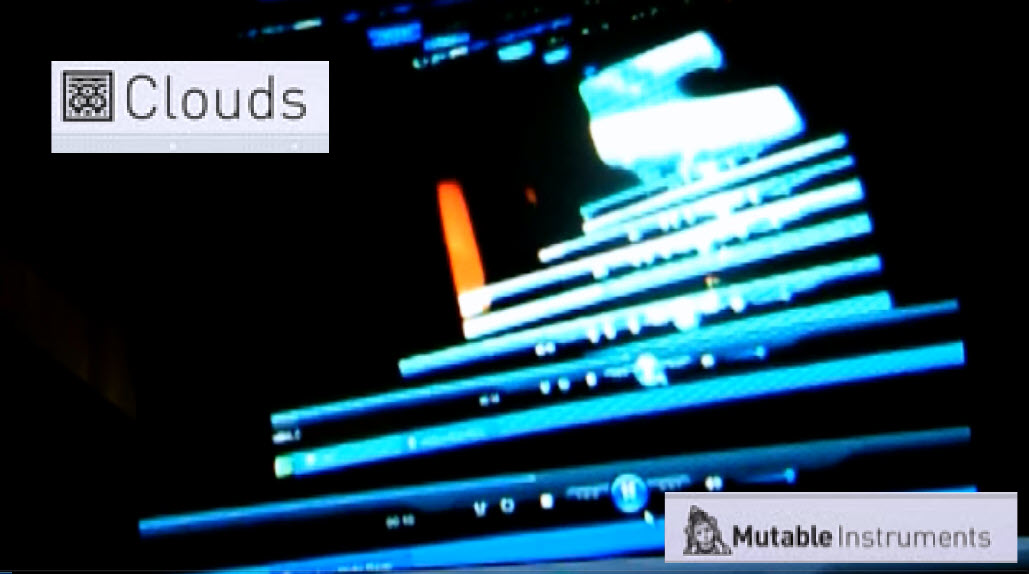

Softube´s Modular Tutorial 13 is available!
View: https://youtu.be/A8YD5RCSENg
The video (1 hour and 41 minutes) deals with the module “Clouds” (Mutable Instruments).
And here is the timeline and content:
Timeline/Content
0:01:28 Granular Processing of Sound – The Basics
0:01:28 Grains
0:02:22 Rearranging Grains
0:02:45 Direction And Speed of Play Back
0:03:17 Layers of Grains
0:03:29 Repeating Grains
0:03:36 Stretching
0:03:50 A Sonic Microscope, Part I
0:04:47 The Buffer
0:06:27 Playhead And Buffer
0:06:54 Manipulating Positions
0:08:55 The Individual Functions
0:09:23 The GAIN
0:10:01 The Audio Quality
0:10:41 The BLEND Modes
0:16:16 Some Details About The Buffer
0:28:39 The Size of The Grains
0:45:17 PITCH
0:49:53 DENSITY
1:01:50 The Texture Of The Grains
1:06:36 The Inputs
1:17:04 A Sonic Electron Microscope
1:26:50 Randomness
1:27:09 Rhythm Building With Freeze And Talking Drum Loops
1:31:27 Delay
1:34:52 A Pitch Shifter
1:36:16 An Enriched Drum Loop
1:37:38 Voices
1:38:44 “Clouds”, Modulated by Audio
1:41:00 The End
Enjoy your day!
Rolf

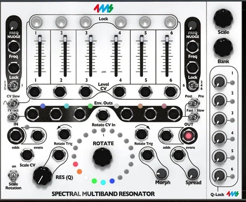

Softube Modular tutorial 17 is available now:
https://www.patreon.com/rofilm_media
It´s all about the 4MS Spectral Multiband Resonator module. It´s public. Everbody can watch it. But only until August 10, 2019. After that deadline only Patrons and/or members of the rofilm-media.net community will have access to the tutorial.
And here is the content/timeline:
Timeline / Content:
00:00 Introduction
01:08 The Basic Functionality
04:45 Overview of the GUI
06:21 Colour Codes and Scales
09:19 The Spread Function
10:25 Scale Rotation
14:44 Scale CV
21:53 More about Scales
25:27 The Morph Function
27:49 The Filter Bands
33:32 The Range of Nudge
35:44 Slew and Moph
36:40 The Envelope Follower
51:23 Resonance Lock
53:38 Some Words at the End
56:41 The Real End
Enjoy your day!
Rolf
