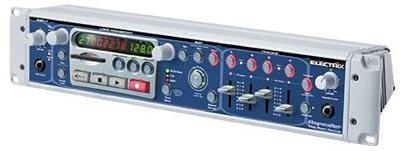

Was für ein Delay/Loopsampler ist denn das?
Musst halt mal die Kommentare lesen...
469 Kommentare sind mir doch etwas viel. Schaut nach Electrix aus, wie z.B. der DSP Vocoder?
Funkdefino (im Moment noch der 2te Kommentar von oben) meint was vom Electrix Repeater, ich kenn' mich mit dem Loop Gedoens net so aus, aber die Stimme find' ich net schlecht...
tapped loop record
tapped tempo
"Loop Point Assist" function automatically trims loop to match BPM
overdub function for overlaying sound on a track
pitch shifting - +1 octave, -2 octave
time stretching - 1.5x faster, 4x slower
"Slip" function to independently shift each track position
Resample function - bounce 4 tracks to 1 or 2 and re-record effects into the loop
Feedback control (only while in overdub)
Single layer Undo
Reverse play and record
"Multiply loop" multiplies the recorded loop
Loop copy
front panel trim controls to edit the start/end points of the loop
Control the level, pan, pitch and position of individual tracks with front panel faders
up to 999 loops per CF card, 16 loops in internal memory
4 mono tracks per loop
8 MB internal memory (1.5 "track" minutes)
8-minute (40 MB) loop limit
Compact Flash Cards for storing loops (up to 256MB cards)
comes with16 MB Compact Flash card (internal memory plus 16MB card gives 4.5 "track" minutes)
file format: uncompressed WAV 16 bit, 44.1KHz
Audio Beat Detection automatically syncs recording and playback to any rhythmic audio source
MIDI clock sync in
LED display shows current loop number, current bar, time signature, and BPM
rear panel pedal input for TRS style 3-button foot controller (like a Digitech FS-300)
Pedal input controls play/stop, record and tap tempo.
Full MIDI control of all functions
midi note-on control over pitch
midi channel set with rotary knob on rear panel
Inputs: Rear Stereo RCA with Phono Preamp or stereo 1/4" line inputs (selectable with rear button), front panel mono instrument input
Outputs: stereo digital audio out (SPDIF), two/four line outputs (configurable as stereo outs or per-track outs if fx insert is not used), front panel headphone output
stereo effects send/return - 1/4" jacks
MIDI in/out/thru
Input level control knob, with LED level indicator
Headphone level control
Frequency Response: 20Hz - 20kHz
Sampling Rate: 24 bit / 44.1kHz
Dynamic Range: >94dB SNR
THD: <0.014%
Max input/output level: +16dBu
Instrument Inpedance: 500K Ohms
Unit size: 19W x 3.5H x 3.5D
aluminum chassis
external "line lump" power supply, works worldwide
