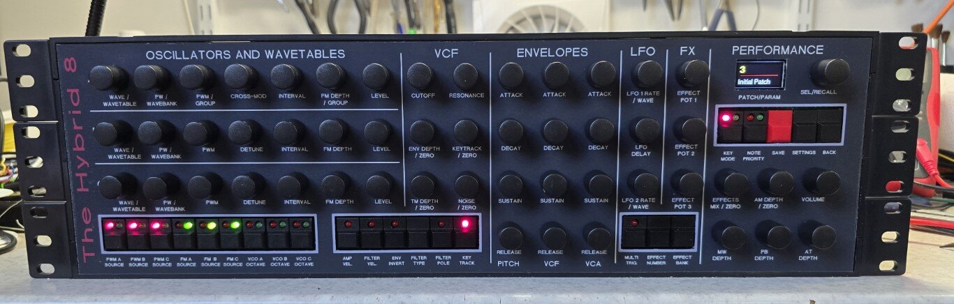

This is a new synth that I've been working on for a few months, it uses the Teensy Audio Library for the oscillators, noise pitch envelopes and LFOs, this feeds a CS42448 board that gives me 8 analogue outputs, the rest is analogue, Shruthi style 4 LP filters, Electric Druid EnvGen8c envelopes.
8 note poly with an FV-1 effects processor and 32 effects algorithms.
