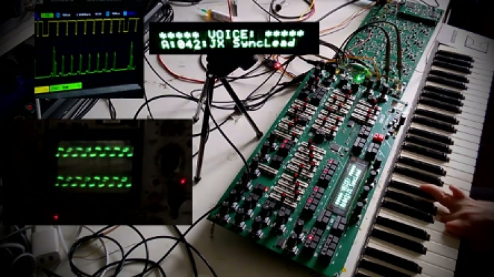

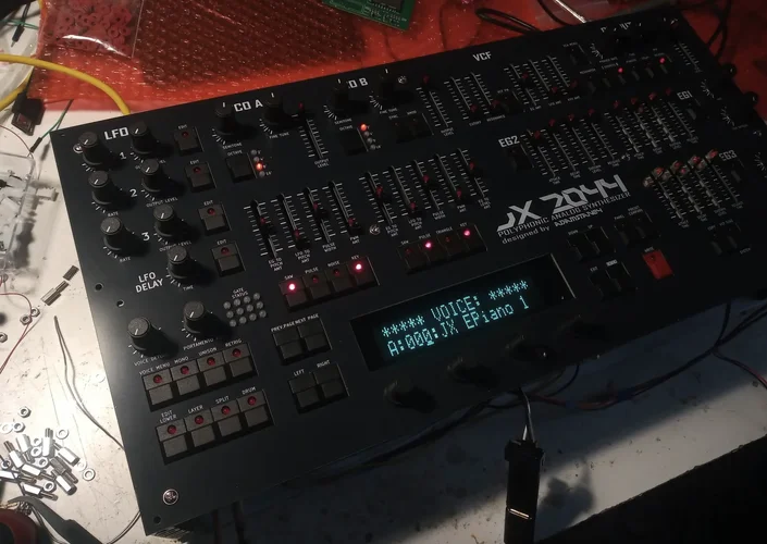

Ähnlich Roland JX DCO aber mit mehr Möglichkeiten!
Bi-Timbral!
Kenndaten:
Initially I tried to use BBD-based chorus, using MN3207 chips, but it was too noisy even for me, so I decided to switch to digital FX.
- 2 DCOs per voice based on JX-8P, but with addition of PWM.
DCO A features sawtooth, pulse and noise, while DCO B has triangle on the last switch instead. Waveforms can be switched independently and mixed.- Cross Mod (AM) - the same circuit as in JX-8P
- 3 ADSR envelopes per voice, with shape switchable between exponential and linear, RTZ switch and adjustable keytracking (with note number affecting envelope speed relatively to C4 (60).
- 3 LFOs per voice with seven waveforms - triangle, sine, square, rising ramp, falling ramp, random and noise. LFOs can be switched to mono mode, or work polyphonically with adjustable keyboard tracking, which is very useful e.g. for PWM patches
- 4 pole resonant low pass filter built around CoolAudio's V2044 chip. Filter can self-oscillate and also has adjustable keyboard tracking.
- Filter FM using DCO B as a source.
- 1-pole master HPF per part similar to the one in JX-3P
Each layer has its own FX processor with following blocks:
- Resonant filterbankwith two modes:
- VP-330 "Human Voice" section emulation (with two presets)
- Polymoog resonator emulation
- Stereo Chorus with three presets - "JX Slow" and "JX Fast" corresponding with "I" and "II" settings from JX-8P, and the third mode is "Stringmachine", which uses three delay lines modulated with dual phase-shifted LFOs.
- 4 stage phaser
- Delay / Reverb - switchable between the two. Delay has its own modulation LFO with adjustable rate and amount. Reverb output also can be pitch-modulated.
