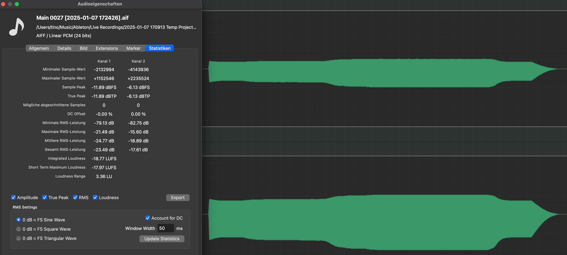

1. Pegelunterschiede beim bypassen von Effekten im Masterinsert - Problem ist bei Verwendung von 2 HD400 (Output Eq + Input Compressor) weg. Die Hauptfrage ist, wieso ist das so.

alles rausgenommen.. das Wesaudio EQ direkt in den linken Maininsert gesteckt. Zack 6 db leiser. Im Bypass Mode matchen die Level. Rechts ist nichts inserted - als Referenzaudio.

meine Frage:
Subject: Level Difference Issue with Hyperion EQ
Hi WesAudio Support,
I’m using a Hyperion EQ as a master insert in my Allen & Heath GL 2800 console. However, I’ve noticed that the signal becomes approximately 6 dB quieter when the EQ is active. When I bypass the EQ, the level difference disappears, resulting in a 6 dB jump when toggling between bypass and active modes.
I’ve attached a screenshot for reference: Screenshot_2025-01-07 18.01.53_HBctSP.jpeg.
For context, I’m using a Fredenstein Bento 500-series rack. The master inserts on the console are TRS connectors, and I’m using an insert cable with a TRS jack on one end and XLR connectors to interface with the 500-series rack.
Is this a known issue? Could it be related to how the connections are made? Do you have any tips or suggestions on how to resolve this?
Antwort:
6dB loss happens (as far as I understood) because You are using non-symmetrical connection – Hyperion as electronically balanced unit, won’t be able to compensate for the signal loss as the transformer balanced units.

und tatsächlich , setze ich das Eq hinter den Main-Out (anstatt in den Main-Insert) gibt keinerlei Problem. Ich schätze ich werd das jetzt so umbauen.
