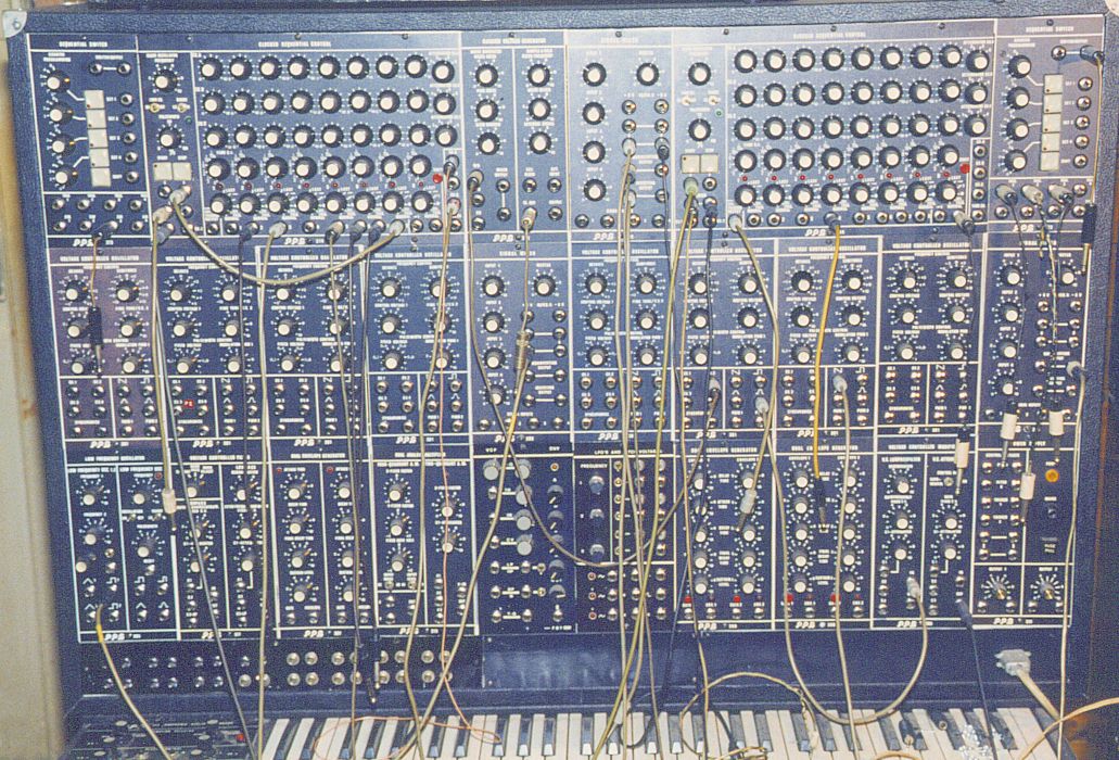

Das PPG Bild war das erste von einem PPG300 und ist auch an verschiedenen Stellen verwendet worden...

OK, he has a PPG 300 Modularsynthesizer and he has built one by himself,
which is very interesting. I took pictures of both, which can be viewed
via WWW at
http://www.physik.th-darmstadt.de/~georg/synths.html
Read till end, there is some K150 info waiting.
Description of the PPG (from top to bottom, from left to right):
First Row:
313 Sequential Switch, 314 Clocked Sequential Control, 310 Random Voltage
Generator, 309 Signal Mixer, 314 Clocked Sequential Control, 313 Sequential
Switch
Second Row:
301 Voltage Controlled Oscillator (4 times), 309 Signal Mixer, 301 Voltage
Third Row:
305 Low Frequency Oscillator, 317 Voltage Controlled Filter, 307 Dual
Envelope Generator, 315 Dual Analog Multiplier, (VCF-ENV/FBY02) not PPG,
(LFO'S AND PITCH VOLTAGES) not PPG, 308 Dual Envelope Generator (2 times),
303 Voltage Controlled Modifier, 311 Power Supply
322 Duophonic Digital Keyboard

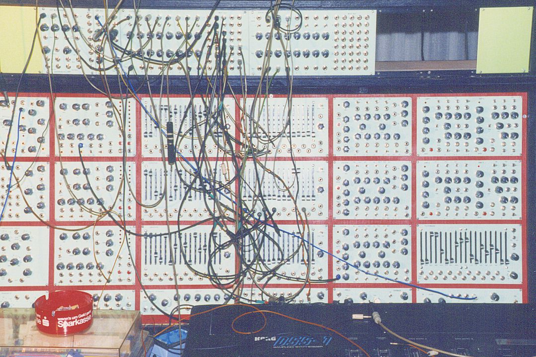

Description of the DIY synth, (I think he called it Modulog)
First Row:
Noise/Tri Proz, Osz, Graphic, Harmonic, Filter, Amp 1/Amp 2
Second Row:
LFO, Osz, Graphic, Harmonic, Filter, Amp 2/Amp 4
Third Row:
Waveform Proz, Osz, Graphic, Harmonic, Filter, Filterbank
Fourth Row:
Ringmod, Waveseq, Karplus Strong, Sheppard, Hall/Chorus, (Power/MIDI) ??
He build the modules from a mixed bag of kits from various manufacturers
(Paia, Formant, some German magazine stuff). Here some additional info:
Osz: The oscillator is mainly used to drive the Graphic/Harmonic Generators,
it's a VCO, I think from Paia, probably the CEM one. The topmost Osz
contains a digital osc too, from Digisound, waveforms stored in a
EPROM are read out, clocked by the VCO. The two rows of LEDs and the
two red buttons belong to the digital osc. The other Osz are prepared
to hold DOs, if he can get them from Digisound, anyone knows the
actual address?
Graphic: With the 16 slider you can "draw" the waveshape. All sliders can
be controlled by control voltages.
Harmonic: With 16 sliders you "draw" the spectrum, again controllable by
CVs. He uses two analog sequencers (one Korg SQ-10 , one PPG 314)
which are triggered when pressing a key to trigger lag processors
(seen on top of the unit) from the gate outs of the sequencers.
The lag processors out is sent to the CV ins of the Harmonic Generator.
Sounds pretty cool. The three HGs are driven in different orders, the
sound is a bit PPGesque.
Filter: Traditional VCF from Formant. Same for VCAs, don't know the source.
Filterbank: Sort of Graphic EQ, but you can set the volume of the bands to
zero. The output of each band is available via the row of jacks.
I forgot to ask about the Waveseq and the Karplus Strong module, but you
may know these buzzwords.
The Sheppard module is from Paia, they had in their 1992 catalog, the one
and only I have.

Ja, das PPG 300-Bild kenne ich auch; das war damals, glaube ich, sogar vorne auf einem Manikin-Labelprogramm abgebildet. Schick.

Dieses Bild schwirrt überall durchs Netz, der PPG ist aber nicht blau, sondern schwarz.
Hier ein Bild, noch vor der Restauration
