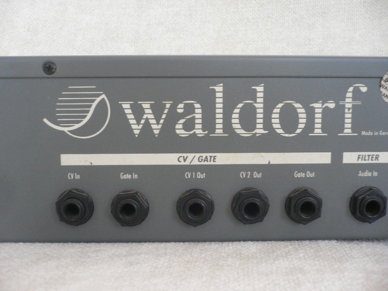

sollte also so aussehen:
dann gibt es cv gat beim pulseplus sollte so aussehen:
dazwischen gehören kabel
sollten so aussehen
das miteinander gekoppelt den pulse auf invertgate gestellt und die sache sollte funktionieren

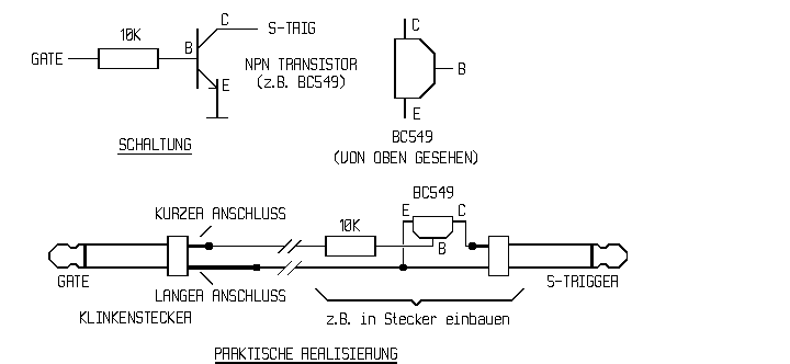

In some devices only gate outputs are available (e.g. Doepfer MAQ16/3, Schaltwerk, Regelwerk, MCV24). This means that a positive voltage (e.g. +5V or +8V) is used to trigger the device controlled by the gate output. Some devices (especially Moog synthesizers) require instead of this a so-called switched trigger or S-trigger. This means that a short circuit (connection to GND) is used to trigger the unit (example: a foot switch making a short circuit when actuated).
A simple electronic circuit made of a 10k resistor and a standard npn transistor is used to convert a gate signal to S-trigger. The sketch below shows this circuit. The resistor and transistor can be built e.g. into the case of the 1/4" jack. If you have problems to assemble yourself the cable described above please ask your local dealer. We offer such a special cable at a price of about Euro 20.00 - 25.00 (depends upon cable length and connector type). Please specify if you need a 3.5 mm or 1/4" jack on the input side and the length of the cable. E.g. for A-100, MAQ16/3, Schaltwerk, Regelwerk or MCV24 outputs 3.5mm jacks are used. For other applications a 1/4" jack on both sides may be required.
http://www.doepfer.de/faq/gen_faq.htm#S-Trig
oder von synthesizers.com http://www.synthesizers.com/gates.html
Converting to Switch Triggers
This special cable converts Gate signals from a Synthesizers.com system to Switch Trigger signals needed to activate Moog envelope generators. It has a male 1/4" plug on one end and a 2-pin Cinch/Jones plug on the other. Here's the circuit if you want to make your own.
QMVS-48 48" Moog Voltage to Switch Trigger Cable (yellow) $27.00
circuit

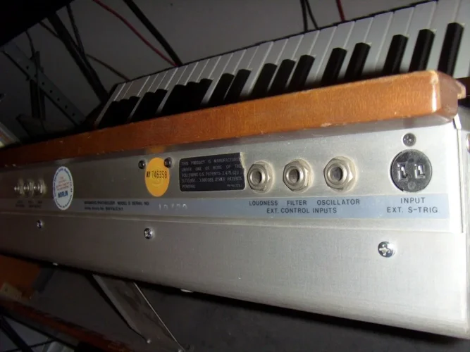

JAASH, ich suche (wie Rudi L. :nihao: ) den Gate und CV Eingang, habe aber gar keinen! (siehe Foto unten, übrigens Seriennummer 10729)
Dein Bild zeigt einen Mini mit separaten Eingängen, womöglich nachgerüstet? Oder gab's das als Option?
ELEKTROKAMERAD + SOUNDWAVE, danke für die Links & Beschreibungen.
Könnte man sich ja selber bauen, so ein Adapter mit Widerstand und Transistor. Man soll dann einen Gate Out mit dem S-Trigger In des Minimoogs verbinden, aber Gate triggert doch nur, was ist dann mit dem CV-Signal, das doch m.E. die Voltspannungen für die verschiedenen Tonhöhen liefert?

schön _ jetzt weiß ich auch was du meinst
ist das photo nun dein keyboard ?
was sind das für buchsen daneben _ vielleicht wird ja nur über diese komische s-trigerbuchse getriggert und cv für oscilator geht daneben rein _ in dem fall würde ich die buchse einfach ausbauen und durch eine normale ersetzen ....
grüße jaash
Die Jones Buchse (ganz vorn im Bild) ist eine Triggerbuchse, da kommt der S-Trigger rein. OSC Control ext. ist dann für CV Key.
https://sequencer.de/synth/index.php/Analoge_Steuersignale CV + Gate
na dann einfach mal ne kaputte klinke abgeschnitten und die kabel darein gesteckt _ das sollte doch funzen ... :lol:
Du musst am Mini dann noch eine Taste drücken und halten, der Eingang wird mit der Keyboardspannung addiert, so kann man Sequenzen einfach transponieren. Der Keyboard S&H hält die Spannung aber nicht so richtig lange. Das kann man mit ein wenig DIY verkabeln im Mini sicher ändern. Nein, nicht die Drift vom S&H, aber die Keyboardspannung abkoppeln.
Wenn man eine Taste hält, löst der externe Triggerimpuls die Konturgeneratoren (Heinz Funk Sprech) nicht neu aus.
Also, ich hab's jetzt hinbekommen. Gate Out in den S-Trigger und CV Out in die Oscillator-Control-Buchse. Letzteres war der entscheidende Hinweis! Dann noch die Voltspannungen für Spreizung und Tonhöhe am Pulse einigermaßen abgeglichen. Dabei fällt auf, dass ganz tiefe oder hohe Töne der externen Tastatur nicht mehr erkannt werden. Egal, es läßt sich ganz passabel spielen, wunderbar !
