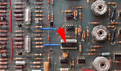

If one key pitched it doesn't matter which one - I hear only and always the same sound. The busbar was cleaned, all contacts - the same problem. I have connected my first Minimoog (which works perfect) over cinch jones - the same problem.

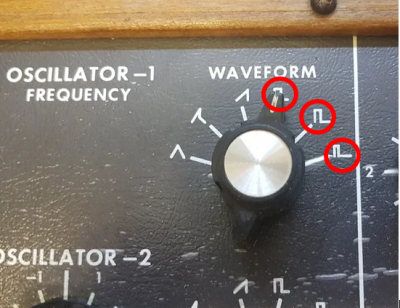

What I also noticed - no changes in sound by these positions (attached photo marked with red), but I think it can't depend on it.

For all three as marked in red circles.
Standard sound is coming without any pulsation.
Well, the first problem I have:
I hear the same pitch / note let's say "B" by pressing any keys on keyboard.
I press C - hear "B", I press "E" - hear the same "B" note. I go to another octave press "G" there - again the same "B" note etc. and this issue I have by all keys if I press.
The second problem:
OSC 1: no changes in sound if I switch between square, wide rectangular or narrow rectangular (as per red mark circles on the pic above).
The first three - work well: triangular, sawtooth-triangular, sawtooth.
Please do not answer "it does not change". I did don't ask "Does it change?".
So once again (it seems to be difficult to understand this question):
What does it sound like, if you set it to Square; does it sound like Saw, triangle or what else?
What does it sound like, if you set it to Wider rectangular; does it sound like Saw, triangle, or square, or what else?
What does it sound like, if you set it to narrow rectangular; does it sound like Saw, triangle or what else?
Please answer all questions.

Regarding the no difference in sound for all the three PW settings and the sound to be very triangle like, I would assume that the comparator LM393 IC 8A is defect or something broken on the rotary switch. This would be for the new OSC board. In case of the old one, that function should be in Q11 2N4058 and Q12 2N3392 or the rotary switch.

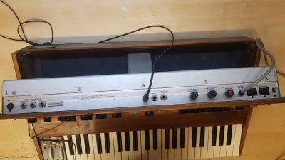

Please provide the SN of your synth and a picture from the backside to see the number of holes for the trimmer. Ideally you would know precisely the revision data of the OSC boards.
Ser. No. 3xxx
Can you please confirm the SN to be 3697?
Picture from the back like this please :)

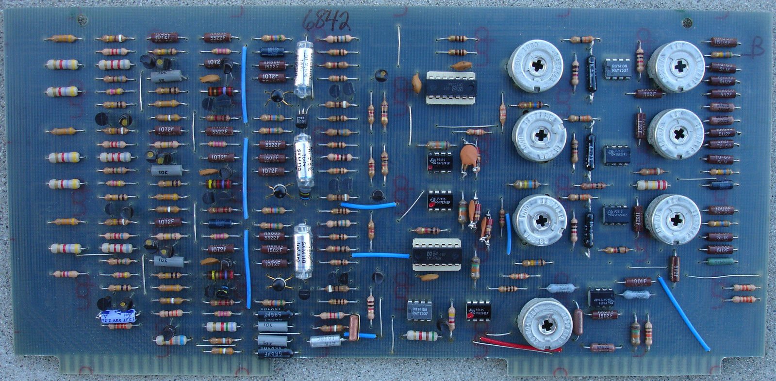

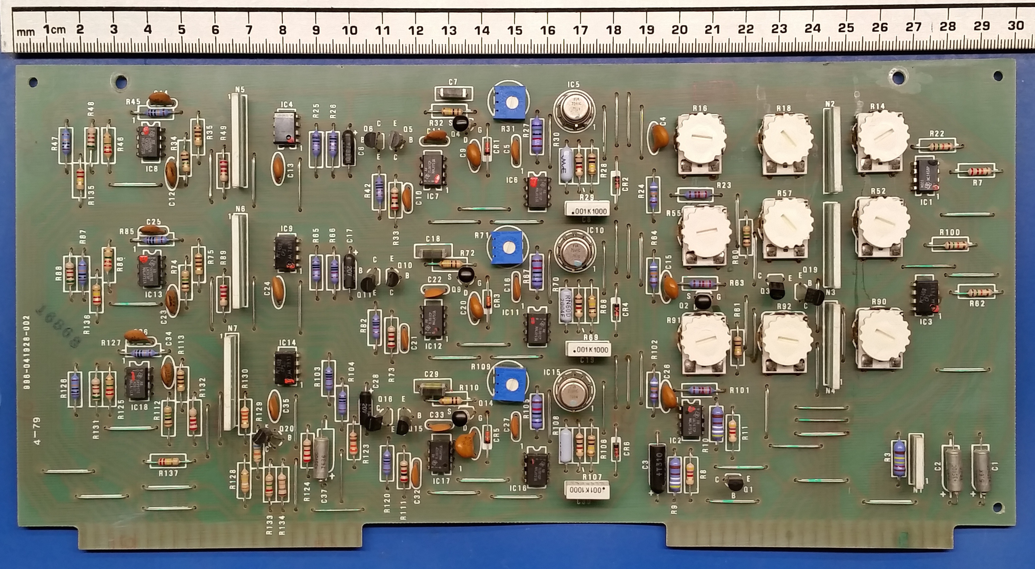

We need to know, which Osc-Board you have, since there are plenty of variants around. Just some examples:
ouUoluJAwG2LWlKt_z6jokFuX426m6GMVACKpRdvO2lXGohZVAMf3oOLCg-2TwSyw-k862Vxy0VspuJPOOpbmb2SkII
Your OSC Board should look like the first blue one. The two 14 pin DIL chips should be LM3046. If socketed you could easily swap them. If the glide error moves from OSC1 to OSC3, then you just need a new LM3046. I suspect the glide problem to come from the LinLog converter for OSC1.
The PWM Problem I would suspect to sit in Q11 2N4058 and Q12 2N3392 or the rotary switch.

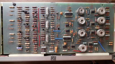

Cool, so my guess was correct. I would remove the board (ground yourself), check all solder points visually, clean the contacts from board to synth with 2-Propanol, do the same with both LM3046 (take great care to not bend the pins). Test. Maybe it helps already. Next step, swap the two LM3046.
If this is not fixing it nor showing a dead LM3046, then you need test/measurement equipment.
Peek visually into the rotary switch and check for broken wires etc.
Just as comment, the potentially broken LM3046 would attribute only to the strange VCO1 glide. Just another idea: If you have a DMM measure the DC power rails under load and compare to voltages given in service manual (GIYF). If you have an oscilloscope, check the ripple on the DC power rails.
One problem solved
Bad contacts were found here... OSC1 and OSC3 work at all positions now
